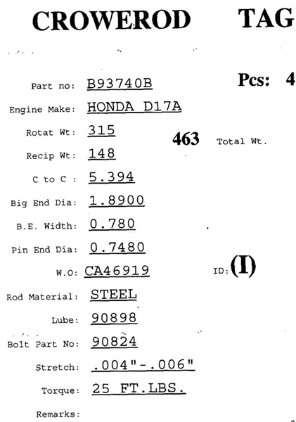

hmmm so why do i have this, if ur saying no one makes them off the shelf, then maybe so, but as far as getting some well this explains it

Read his post again man he said there IS one company that makes them.

yup that is the ONE company that makes them.
sorry for the confusion, what I meant was, there are no off the shelf D17 rods from Eagle yet.
and how much did you get your Crowers?

650 or so, its been a year since i bout them, by saying pricy i thought u meant like titanium rods or something real special

ya at $650 for just Crowers, I feel that is pricey. Crowers are good but I dont rank them that much higher than Eagles for being that much money.
for a couple hundred more you can already get some aluminum rods
