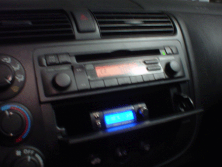

It was an easy install took just over an hour because we took the time to route the wiring and vacuum line through the firewall by the glove box. The reason why I chose it was because it displays PSI in real time and it was considerably cheaper than the Apexi AVC-R. I am still learning the settings so if anyone has already figured it out please reply.

New settings (changed to reduce spiking):
Low:
SET: 14%
GAIN:7%
SET GAIN: 4 psi
Now the pics....

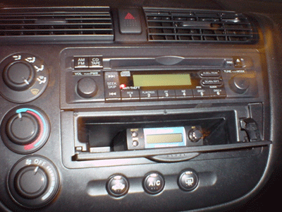

more

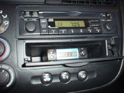

another
