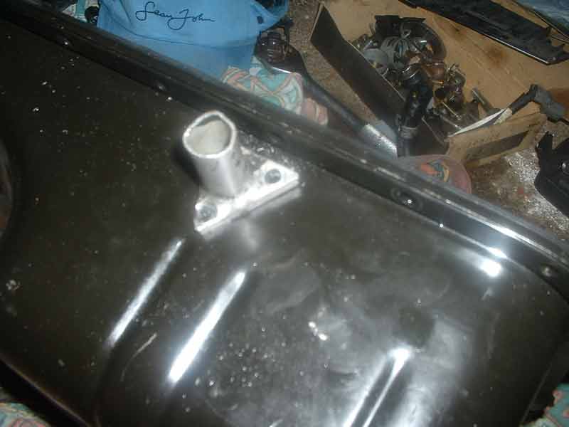

hey dober from what i can telll.... YOU installed YOUR drain fitting to the oil pan backwards... lmao. didnt it seem aili short? haahahah
ahh...yes it did but ya know what...IT WORKS!!! haha...it doesnt really make a difference cause i clamped the **** out of the return line anyway lol
i think i was so proud of my oil pan drilling that i didnt take the time to think about how it was supposed to fit

^^^ just wondering what is wrong with the oil pan fitting, so i know for when i install mine.

look its backwards.. heres mine what its supposed to look like..

damn bro yours is mangled...
i should have placed the tap on the outside of the pan instead i went from the inside of the pan and stuck just the main hole through...either way it will work but i guess oso's way is the correct way.

yeah that flange got f-d up hardcore lol. when u do it, i reccommend high-temp red silicone. It was recommended by others on this site and it definately works well. Also keep in mind you need to re-bolt your oil pan after your finished so make sure not to block any bolt holes what would be above the flange...

I didnt get f-d up u asses... BLAME our great and wonderful Derek-CEO for that... that ******* must have crunched that **** with plyers...
either way tho... thats the number ONE thing i HATE about this kit.....
Im getting a SS line put in. I dont like nor trust rubber next to my exhaust... not to mention if it breaks there goes my engine.

when i bolt the oil fitting to the pan, should i weld it too, or is that overkill.....i dont' want any leaks.
welding will be safer upon leaks, but red silicone sealant works as good.

red silicone for me!
oso, i'm not an ***!
i used the red silicone too.. and it was just a statement. no pun intended.
