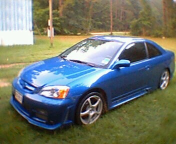

That is what I am saying too...lol. Saving my pennies now for the turbo (and new body kit/new paint job/and new suspension).

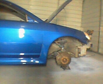

Thanks man, it was fun getting the car to where it is at now but I am ready for a rebuild.
