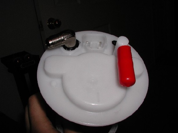

I think the best thing to do regarding the fuel tank is to possibly buy the fuel "filter" assembly from majestic honda so that I can drill and tap it..
This would make things easier when I start to take things apart...who knows tho.

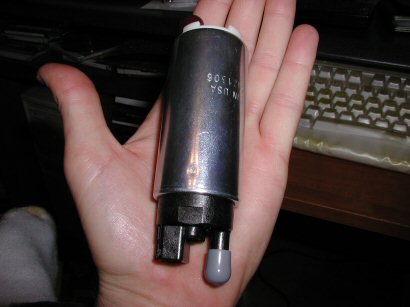

photo of the walbro pump....its so tiny its almost cute (ha, ya right!)

You have big hands. LoL That thing doesnt look so small in mine. HAHAH

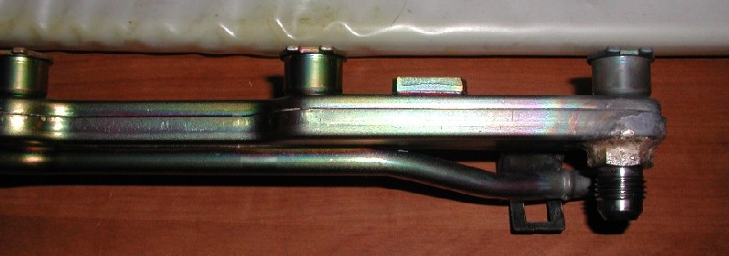

Check it out - converted fuel rail with a -6 AN steel fitting brazed on....

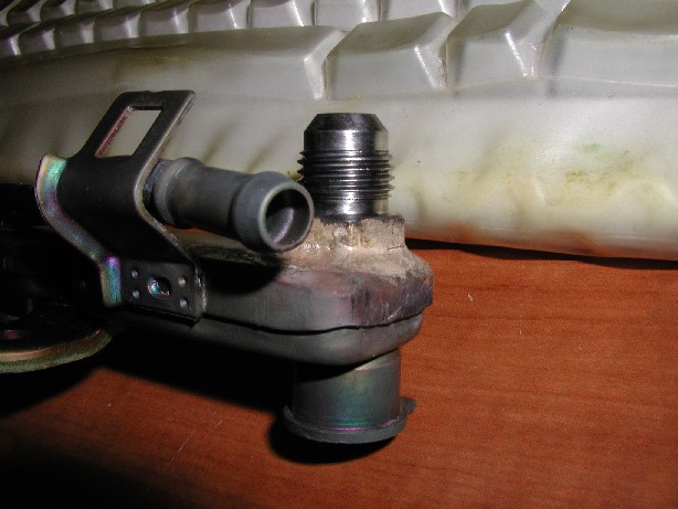

Shot 2.....he charged me $50 to braze this fitting on, and weld some aluminum brackets onto my intercooler....not a bad deal!

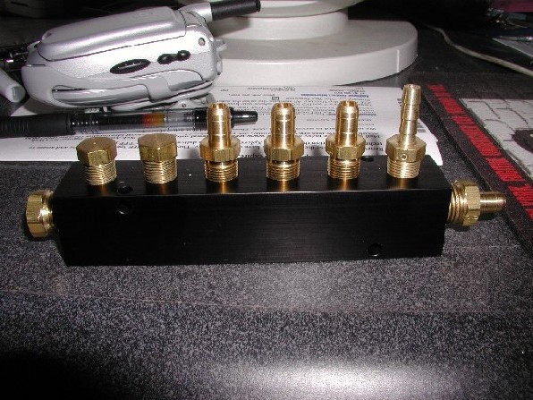

Vacuum manifold....going to be tapped off of the brake booster line. Everything gets connected to it (BOV, wastegate, etc)....McMaster Carr, $27 as seen...

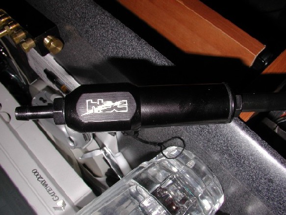

Modified fuel filter.....-6AN to 3/8" NPT fitting installed using RTV gasket material to seal it up.....

watch out, me and boosted2k2 have both had fuel lines pop off right there bc of pressure, so if for some reason in the near future, and i say near bc it was not a weak after boosted did his in tank pump it poped off, check there first

Pop off as in how? Did the fitting come out of the filter assembly? Did you guys use a tap to thread the filter assembly?

DO NOT tap the break booster line. It has a 1 way valve right in the manifold. You will have nothing but 20 in of vaccume all the time. Believe me, that was the first mistake i made while turboing my car.
