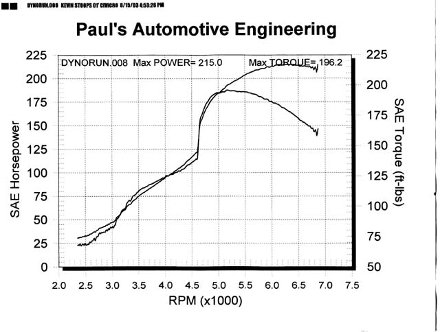

here

damn 215hp @ 11psi.....u do n e thing special to handle the boost?

return fuel system, engine swap, je dish pistons

how did u get your return fuel system

had a shop make it
with a regulator, some fuel line, in tank pump, modified fuel rail, 4-440cc rc engineering injectors, fuel line fittings

I've seen C2i0v0i1c's car in person. And I've talk to the owner of the shop that built his car. Tim(owner of BR) showed me everything he did to C2i0v0i1c's car. They did a hell of a job on his car. Very clean and it makes lots of power.
Did Tim ever get your car tuned at 13psi?
