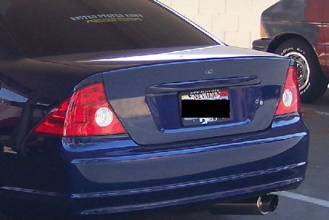

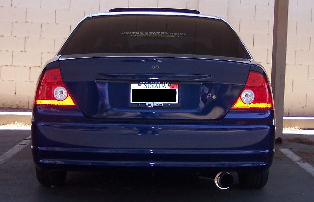

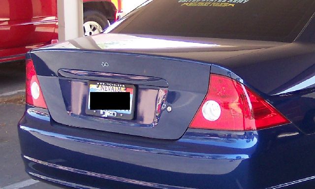

yes! but you have to get rid of the smaller brake lights!, 01-03 got 4 lights(2 lights for brakes) 04 got only three! I just did the swap last night with my TYC Euro Tail Lights! I love em!
--and ow you need the 04 bulb socket connector that goes to the signal lights slot, coz the 01-03 are too small! but if you have tape and silicone paste then that might work!
