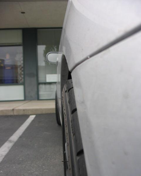

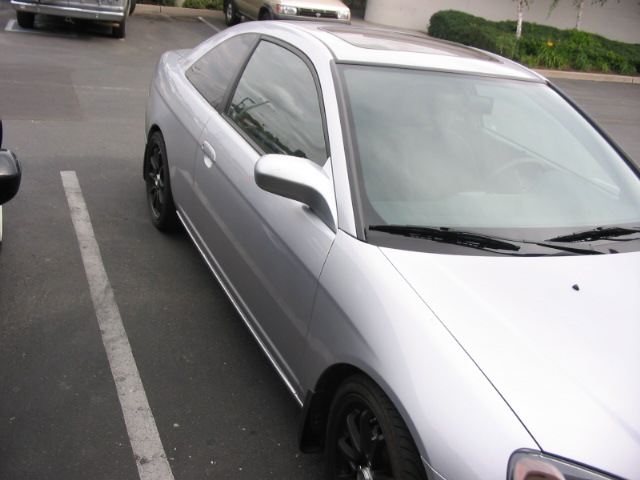

tenzo formula 10s...
i've been rubbing the rears on bumpy roads

i have 215/45/17 and no gap front/half finger gap rear. my rear fender would rub against the rear fender lip so i adjusted my rear camber so its little negative. if you have a rear camber kit, it may be a good idea to give it a little negative in the rear.

yeah i've been planning on doing that too, but i was gonna roll my fenders to be safe also...cuz i'd rub all day with 0 camber and a 2 finger gap...i raised the car up because it was so bad
