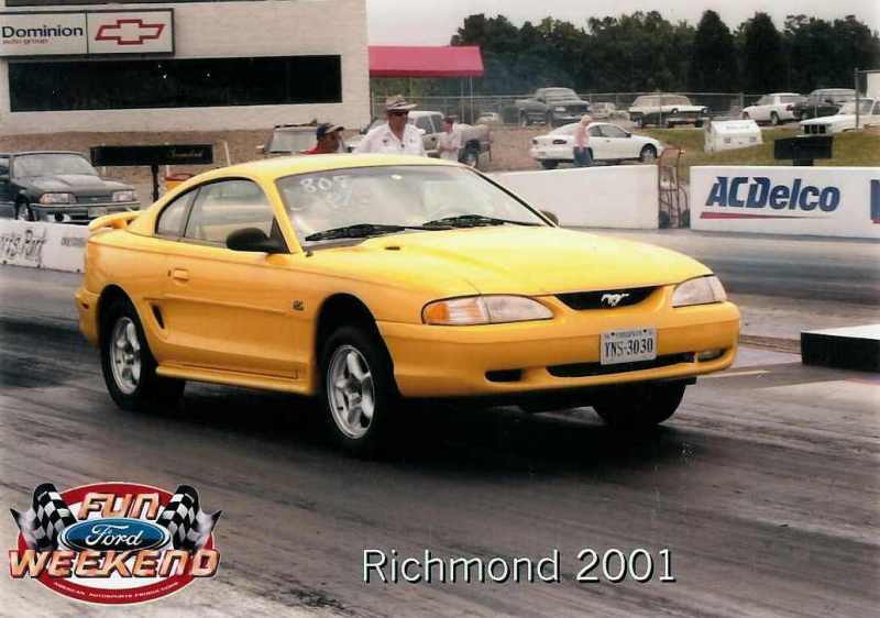

andyman 25psi would still be to much drop it down between 10 to 14psi and make sure you drive around the water box with drag radials and do a dry burnout in 2nd gear to get enough wheel speed pull strait up to the starting line (don't do a dry hop that will shock the heat out the tires) when you launch your car slip the clutch a bit so you don't hit the tires too hard, with a little bit of practice you should be cutting 1.9 to 2.0 60ft. or you could just ditch the drag radials and buy some slicks for instant 1.8 60ft. Also if you want to shave another .10 or more off your 60ft I can get you hooked up on some sweet tire dope
Here my old stock suspension bucket of **** cutting another sweet ***
1.65 60ft.
The pic was taken at Virginia Motorsport Park I use to live near Richmond and now live in Canada and that explains that incase your wondering,lol

Originally Posted by drunkenmagnum
what rpm did you launch at?
I dunno if you talking about andyman97 or me anyways I left the line @6500
had a Ford Motorsport RPM Extender to over ride the stock computer rpm limit of 6200.
1.65 60ft.
i'm pretty sure launching a civic and a mustang are two totally different things.
yes ... very very very different.
106 trap speed, hmm? ... you should be mid-low 13's with some slicks
