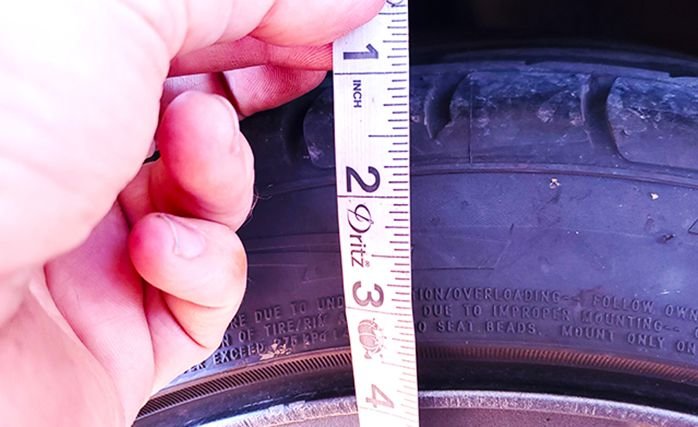

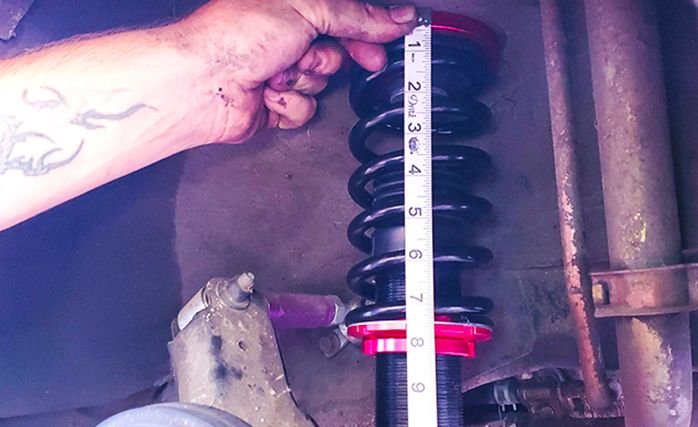

The process is pretty simple though, should you wish to take it on yourself. Simply pre-adjust each coil length, before installing, by loosening the bottom lock nut and raising it up to where you want it to sit, then raise the lower shock body till it meets and locks again with the lower lock ring, (right tightly, lefty loosely fashion). When you’re satisfied, they should measure equally from the top of the body plate, to the top of the lower lock ring (see picture 1)
I measured mine to 10 inches on all of them. This is done before pre-loading and tightening them down.

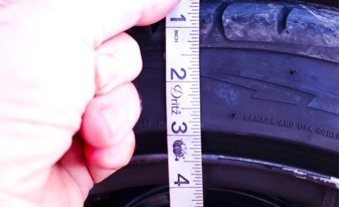

After all, have been completed, replace your wheels and remove your jack stands and lower the vehicle to the ground. Once it is on the ground, measure each wheel. These measurements will be taken from the bottom lip of each fender, to the top lip of the rim (see picture 2 and 3)
You will notice, right off, the rear measurements will differ slightly from the front. This is okay, as long as they are the same on each side; rears and fronts. My setup put me at 4 inches on the back and 3 and a half inches in the front. You can adjust the height as needed, if you want them higher or lower (there is AMPLE adjustment range here) should you desire, and Maxpeedingrods has supplied an easy-to-read instruction sheet to help you along the way with this!
