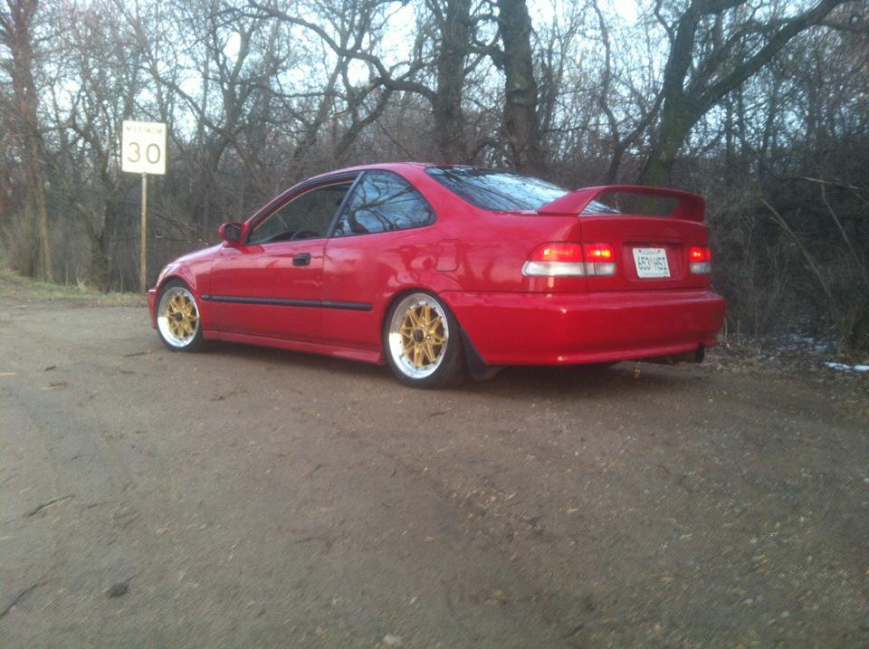

re: Boostedlsvtec's Turbo Build
Wow, nice engine build you have going. I imagine you're looking for 500hp+ given the sleeved block eh?
Do I see a bit of reverse rake or is that just the photos?
(I'm going to move this to member rides, I'm sure people outside of Western Canada would be interested in following the build)
Thanks man and yeah shooting for 500+.Lol yeah got it lil low in the back. It was right after i dropped it on skunk2 coilovers. i got to lower the front a little more
