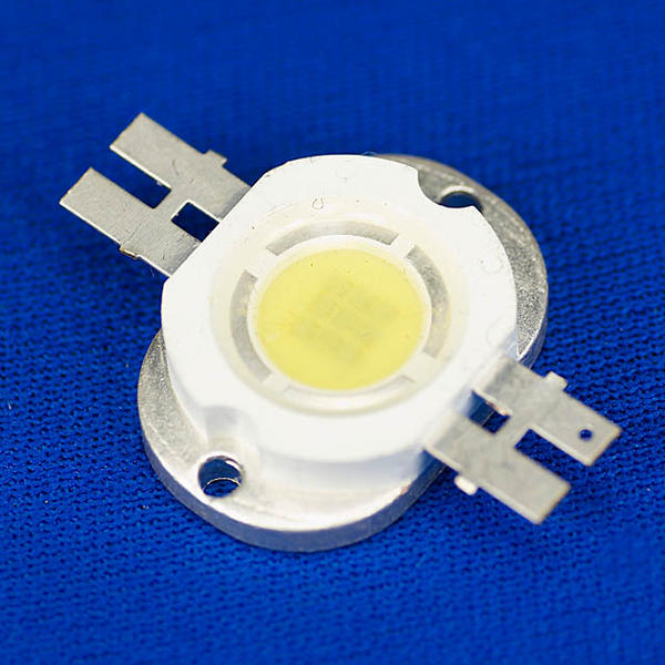

Here is a pic of the LED...

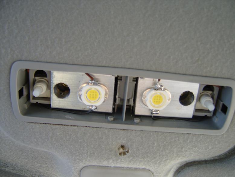

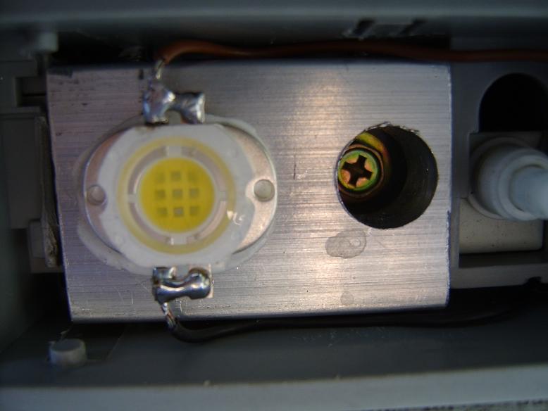

Here are a couple pics.
ID:	74664   Click image for larger version

haha wow you are crazy lol. the 1w amber i have in mine is perfect brightness around 30 lumens. there are limits to some things.

also im not sure that heatsink is big enough. and on hot days with sun shining on it, the metal gets hot enough to burn you. so idk how long they will last being attached like that...

ya I know im gonna switch the emitters out to SSC P4 leds. Ive left them on for 15 mins and the heatsink gets up to about 150f lol so ya they wouldnt last too long like that.
