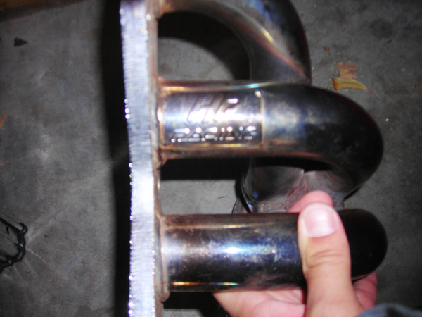

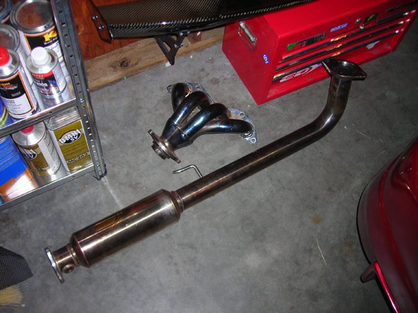

Ok so I'm still trying to wrap my brain around this concept, because I don't know what's underneath the EX.
Quick back story,
I bought some games off some guy in my area through craigslist, and it turns out his brother had a 7th gen EX which he was selling his aftermarket header for. I was like "How much do you want?" He says 35 bucks. So I I'm like what the hell, lets see it. So he comes back with a used manifold and this down pipe looking thing, which looks pretty decent shape, especially for 35 bucks, it looked great. When he came back, he said that his brother told him that it was a Megan Racing header. I looked on the header and it has a little metal tag welded on, that says HP racing So i have no idea what it really is or if hp racing is just part of megain, but I bought it anyways.
This is what it looks like:
I got home and searched on the internet, no luck finding anything with the search term civic and hp racing, but I did find an image searching civic and megain racing which looks exactly like what I have:

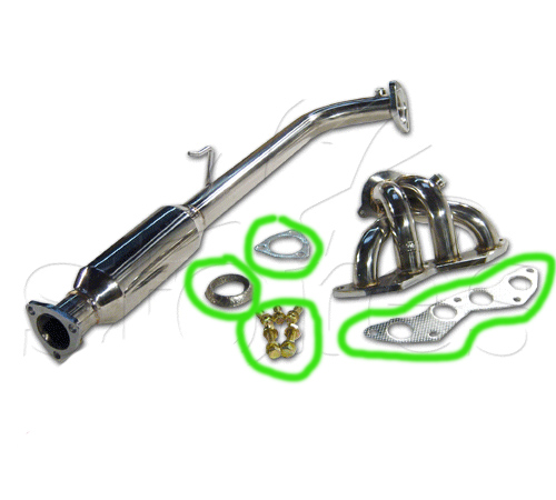

Here are the problems, I think....
Pictured above, I never got those gaskets and bolts from the seller, can I use what's already in my engine bay? The stock bolts and gaskets? Or do I have to buy new ones from megan racing?
I have an LX and I'm seeing that these units are only sold for EX's, Does that mean I have to get an aftermarket or EX catalytic converter and weld it in line with the rest of the exhaust or something?
If I have to get a cat welded in, then I might as well just get a universal muffler and get a pipe bent to fit and welded in cat.
Can anyone please help? Im I missing anything?
Thanks!

just get new OEM gaskets.
Old Aug 11, 2007
Rep Power: 512
Re: Help me with new exhaust parts if you're bored
i replace the cylinder head side gasket every time i break that seal.. the little doughnut one i reuse though.. as for the bolts, the stock ex manifold has nuts welded onto the downpipe connection flange, so you can use your stock spring bolts as long as you grab some nuts and probably lock washers to go with it.
and since you're bolting it up on an lx, you're gonna need to get a cat if you wanna be emissions legal, but i think you still need [official] documentation saying your original cat went bad/was defective so you replaced it.. also, you're gonna have to extend your O2 sensor wires to accomodate for that..

Ok, sweet. I'll do that. What about the bolts that connect the header to the block? Can I re-use those?
Old Aug 11, 2007
Rep Power: 512
yep.. should be able to.. just remember that they have torque specs.. crank down on them and you'll strip out your block

ummm yeah about that...you have studs and nuts...that sounds bad...but you can use your stockers for that too...they will work just as well
Ok I gotcha, bolts and lock washers from the local hardware store. Thanks
What about the bolts that hold the header to the block?
So If i were to purchase an aftermarket EX cat back system, and an aftermarket catalytic converter designed for the EX, Can I bolt it up at home? I want to avoid taking it somewhere to be welded/done for me.

I'm not sure what you mean? You're saying it's ok to re-use the stock nuts/bolts whatever, that hold the header to the block?
What sounds bad?

yeah, just use the stock parts, they are the same as those aftermarket ones

i dont think the donut gasket from ur oem manifold will fit the aftermarket one. it didnt for me. im sure u have a hp header if thats wat it says on the header. if its a megan...um same difference i guess. wont make much of a difference. i would change the cylinder head gasket between the header and the head. now...im guessing u didnt get that extra part in that picture u posted up did u? that would be ur test pipe. thats what replaces the cat in the ex versions. if u had both of those it would work..itd be kind of like converting to ex..but ur gona throw CEL's. so.. i duno. anymore questions?? for 35 bucks thats great.. i would buy the cat from dezod or the megan test pipe from dezod if i were u. extend ur 02 wires and u should be ok..
Old Aug 11, 2007
Rep Power: 512
the doughnut gasket fit fine on my kamikaze header paired up with a random tech downpipe..

i have an obx header and my oem gasket didnt fit. and still havnt gone to NAPA to pick up another one so i have a disgusting leak.

my oem donut gasket did fit with my megan header and test pipe. i did however buy a new one from Honda.... its was only a couple bucks.

honda OEM doughnut gaskets are 10 bucks from hondaautomotiveparts.com.. 14-16 at a dealership...

If I were to buy that high flow cat/down pipe, and then buy an aftermarket 'cat-back' exhaust system for the EX, can I just bolt it up at home on my own?
I'm trying to avoid taking it for welding and such.

Yep.. That random tech downpipe/cat is a direct fit to an ex system. That's what I meant by "it bolted right up." I would recommend getting that gasket kit, too. You get a new doughnut gasket, downpipe-midpipe gasket, and new hardware for both the header-downpipe and downpipe-midpipe connections.
