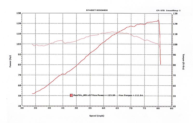

Just got back from the dyno. I am pretty happy with the results from some basic mods and untuned. Here is what I have done:
- V2 intake
- hp race header w/ cat
- crower stage 1 cam
- Ex Mag RSR exhaust
- bored out throttle body
Best pull on the dynojet
hp = 123.59
tq = 111.84
Maybe 130 whp with a really good tune??? Anyway, here is the chart. Questions, comments or snide remarks welcome!

No added fuel? and what do you have an ex?

Nice man!
Im going to get the stage 2 crower cam & tune it with my VAFC2
nice numbers tho.
is it smooth up to red line?

thats not too bad! i put down 110HP "forgot the torque" with ebay intake STOCK ex exhaust mani catless downpipe and full 2.25inch exhaust.
Now i have injen SRI and Megan header and full exhaust. so prob not much improvement. top end is a LITTLE better but not much. but good job on the numbers! im more impressed with the torque than anything. keep up the good work! oh and my dyno run was on a.... damn forget the name of the brand but it reads less that what you actually throw down so i was prob around 115-118HP really. with a good tune you could get 130 easy off that cam tho man. EASY. have fun! happy tuneing!

nice numbers for a N/A D17.
i dont mean to hijack your thread, but do you have any kind of engine management or piggyback with the crower stage 1 cam? i'm debating on getting this, but i'm not sure what would be required to run this on our cars.

Yes, Ex 5spd. Just running on 87 pump gas.

Good #'s!
It is a little over 10% gain over stock. Not too shabby.
Most stock EX dyno between 108-113whp.
I personaly dont think you'll need any tune, since your mod's are on par with stock ECU to deal with with injectors have room to add extra fuel.

yeah you really arent going to gain much if any for the $600 youll spend on the dyno and tuning device. the stg one cam isnt too much different than stock

The stage 1 cam idles very stockish and is smooth from idle all the way to redline.
Since this is my daily driver, I wanted to keep things pretty streetworthy. Basically why I went stage 1. Props to Eddie at TrueHonda.com on the header and cam recommendation. And yeah, Eddie said no engine mgt is needed with the stage 1.
I may still try tuning with a vafc2 at some point just to see what happens but I will probably focus on suspension next.

I thought Civic Ex were 127hp stock. =\
