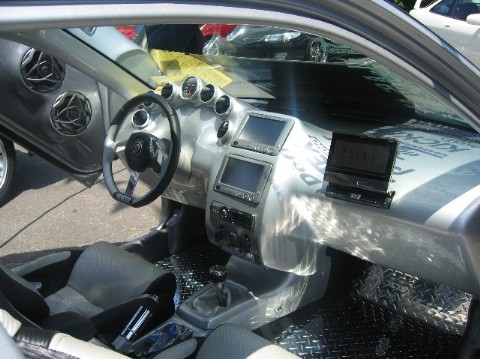

Most if not all 7thgens have the leather dashes right? Well this guy has an awesome interior. What did he do to make this plastic/fiberglass look stock. is this something that would have to be custom done. exclude the guages cuz the answer is obvious on that, but every thing else? can someone shed some light on the subject...

Its all fiberglassed, You would either stretch fabric over the dash and resin it then lay fiberglass then resin it and build up a layer or two or three, then bondo and the sand. Then paint. And you have a fiberglass dash.

lots and lots of bondo, and even more hand sanding, and even more wet sanding, and one hell of a paint job.

The smoother you can get it with as little bondo the better, you don't wanna use alot of bondo, and just a regular paint job, just like painting a car.

you have to do all that for a fiberglass interior? what is this resin your talking about? And are there shops that do this for you? Any idea on cost?

The big hole where the airbag is looks gay and it doesn't sit flush with your vents or dash where the cd player is. I don't think it would look right, the resin is the hardner for the material and the fiberglass. It is what makes the fiberglass really hard. And yes shops will do this for you, some body shops may, and some stereo shops may, but its gonna cost you alot of money for it. Unless you know someone its gonna run ya alot of money.

lol BIG's interior is sweet.... the mushy part on the dash was stripped of the vinyl and the foam underneath, and then bondo'd overtop with a fiberglass based bondo of some sort. All the hard plastic is basically sanded and painted.
