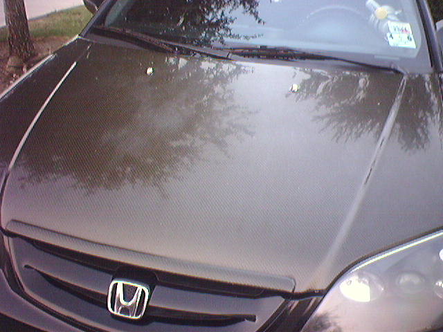

Hey ya'll. I need a lil help. I brought a C/F Hood for 450 from a performance shop called Intercrew Racing and its starting to fade in some places. Do I need to buff it with wax are did I just get fuc*ed. It doesn't have a name on it. Not sure whats the problem, can someone give some sugestions on what i should do, i brought it about 8 mths ago at the most....

i have the same problem. i bought a TCSpoiler CF hood which i was told had really good quality. i have had it for not quite a year and it looks like crap in the upper drivers side where the little ridge in the hood is. it looks like water got between the layers of CF or faded really bad cause it doesn't match the rest of the car.

Oh ok, cause im really pissed.. My hood is faded and there's really nothing i can do about it,.. so its fading cause of the quality of it...

my friend had that happen to his, all he did is had it resurfaced with urathane(?) and it looked perfect. im not sure how much it cost. but it was well worth it.
He took it to a local boat shop, and they did it for him.

I'm taking a guess...but maybe its the clear coat on the hood?

Well, I guess ill have to check a boat shop out, cause there is no way im gonna drive around with a faded hood, thankx.... And yea i think its the clear coat!!!

its a bad clear coat on the hood..... go back to the shop and tell them they have to put a couple new layers on your hood cause of the **** job they did

I'll try but you know how these shops are, the are not gonna help me out, I told them and they told me oh well you know c/f hoods dont last 4ever, and i'm like ****,... dam $500 4 6mths. But, i already know they're not gonna replace or fix my hood, but ill try and see what there gonna say...

You can just take it to a body shop and have them throw on some new layers of Clear Coat.

Get the hood re coated and your good to go...... make sure a good body shop does it

eh... u gotta take out the old clear coat before putting the new coats in...

same thing happen with my home boy girlfreind carbon fiber hood just have to get new clear coat.You that that cheap carbon fiber hood for 450, you got ripped.I got my vis carbon fiber hood for 300 it don't need any new clear coat and i had it 5 years now

u dont have to strip off all of the clearcoat...all u have to do is wetsand it with a gray scotchbright or 500-600 grit wet/dry sand paper and than after it drys u it should be scuffed up enough for u to use wax and grease remover than respray clearcoat on top of it
