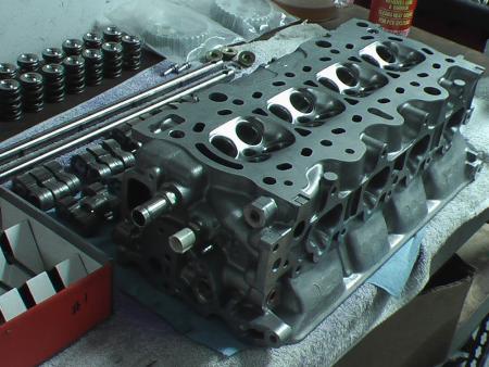

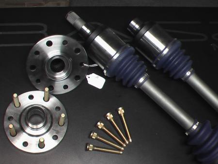

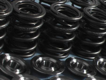

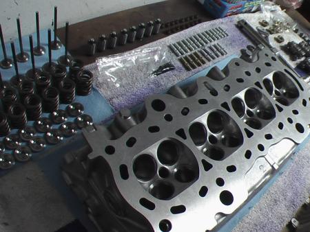

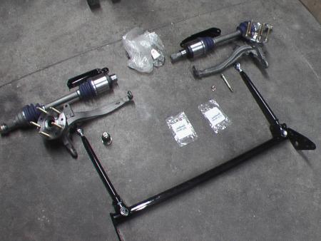

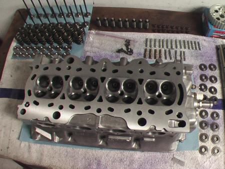

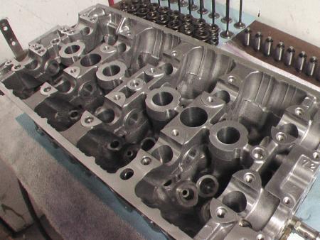

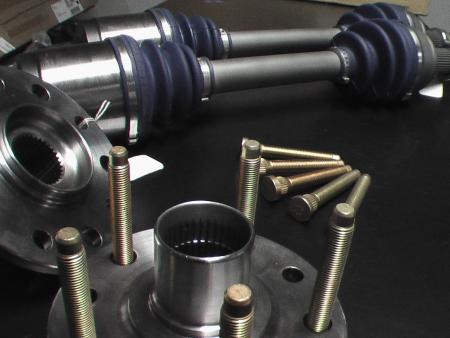

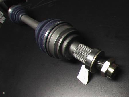

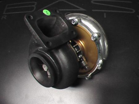

Here are some pics of the Stage 6 axels and hubs

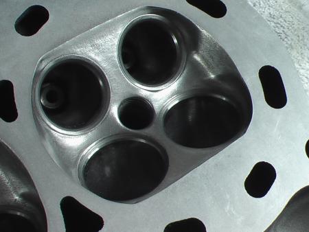

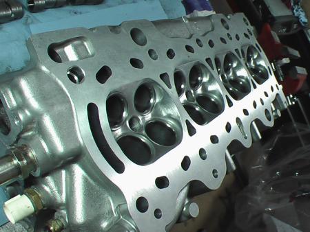

BASZ R-Series Turbo Cylinder Head

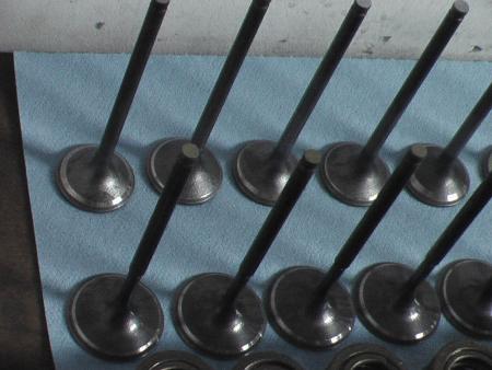

-BASZ Inconel Flattop Valves (Back cut 20 degrees)
-Eibach EVS Performance Valve Springs
-PEAK Retainers
-New Type-R Valve Keepers

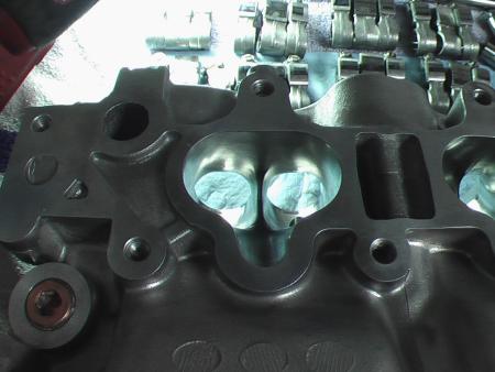

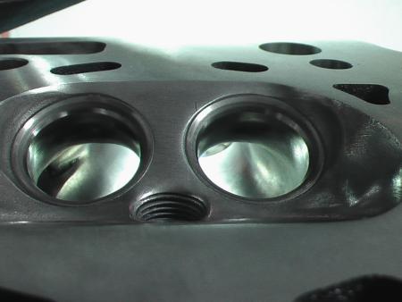

BASZ Enlarged and Polished Exhaust Runners (Heavy Material Removed from: Ceiling, Walls & Divider)/ Ported & Polished, Deshrouded Valve Bowls (Intake and Exhaust)/ Deshrouded, deBured, Ported & Polished Combustion Chambers (enlarged to 84mm.)/ Performance 3 angle Valve Job (Turbo)/ Match Ported Intake & Exhaust Ports/ All Gasket Surfaces Decked & Milled/ Removed studs- ReInstalled All New Intake and Exhaust Studs/ Polished- Cams, Cam Journals in Head, Rocker Arm Surfaces.

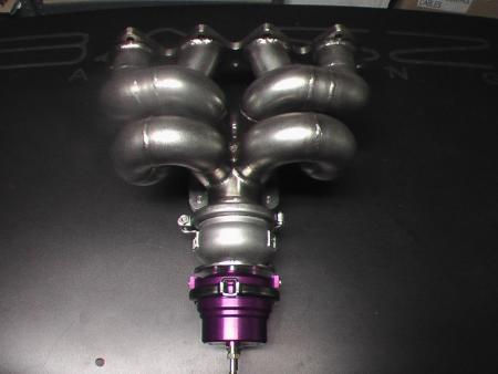

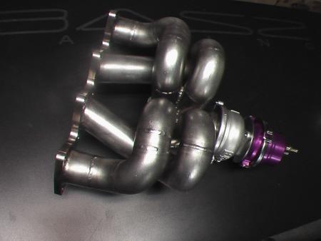

Manifold with HKS GT2 WasteGate

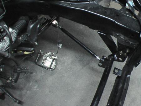

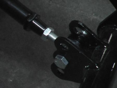

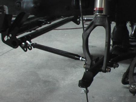

Traction Bar Setup

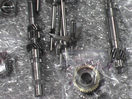

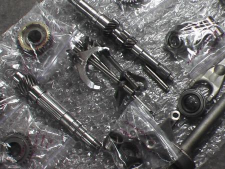

Tranny back from Being frozen. These Photos were taken over the weekend, after Tim cleaned and orginized everything to be sent out yet AGAIN! to go get Coated.

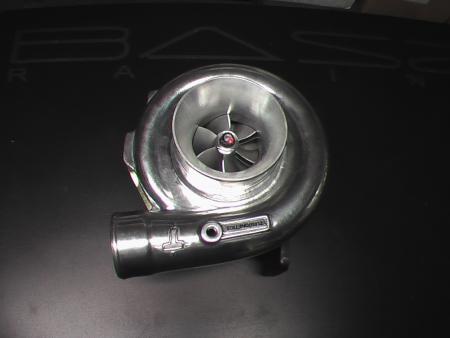

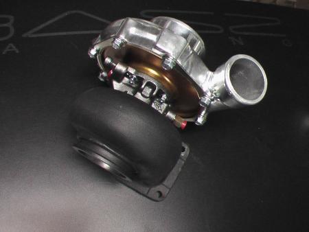

T66 Full Ball Bearing Turbo

"Hector just came in, he's gonna be running 3 honda civics with nos, plus he just came in and bought 3 T66 turbos, and a motec system exhaust."
But seriously, that looks like gorgeous work. Goals in mind?

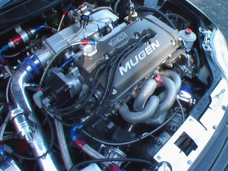

as if it really mattered but here it is
last year
Currently

Goals in mind?
single digits

whoa... I LOVE that exhaust manifold, with the purple anodizing...

last season he ran a 10.98 with just springs and retainers in the head. and welll a built bottom end and as the "last year" picts looks
Old May 10, 2005
XxJDMCivicxX's Avatar
Posts: 2,699
What type of engine? LS/VTEC, GSR, b18b? 10.98 that's impressive to say the least congrats. I don't see why he shouldn't be in the 9's this year .
B18C1
Old May 10, 2005
C2i0v0i1C's Avatar
SuperMODrizd
Posts: 26,407
From: Lexington, KY
Rep Power: 585
Originally Posted by civvic2k1
Ballpark figure of how much a setup like that cost
OVER 100G. but that includes alot more than just the engine
this is also in a 98 hatch
