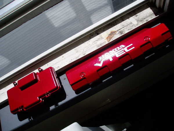

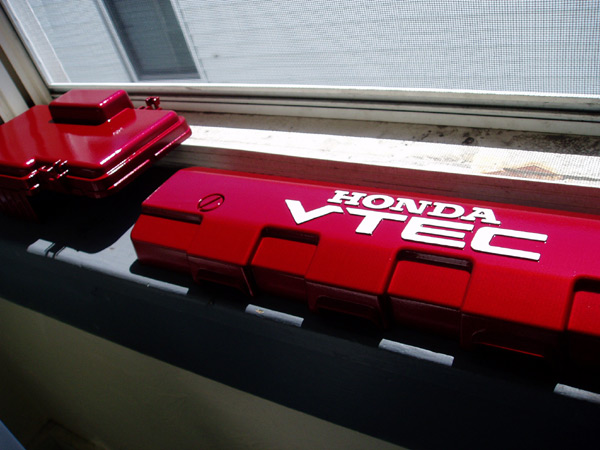

repainted the engine cover and fuse box cover...im doing a photoshoot this weekend ill post em here.. i used anodizeit by pasty-kote. i sand blasted the old paint off and used my cars touch up paint for the white lettering after i threw some clear coat....getting ready for HIN april 30th
paint is good till 500deg its been 2 years since i last painted it
tomorrow in going to work and mask the spark plug coils to blast them and repaint

looks like it's type-ready.

I am thinking of doing the same thing. But it should be able to handle like 1200 degrees. Im not too sure how much my car heats up when boosting. So I need something a little more high temp.
Looks awesome, I love your car as always, one of my favorite sedans on the site. Keep up the clean work

they have 1200 deg paint check it out @ autozone

Looks good. Will you be painting any other parts?

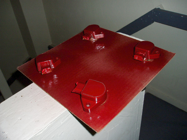

yeah im doing all 4 spark plug coils

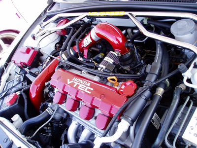

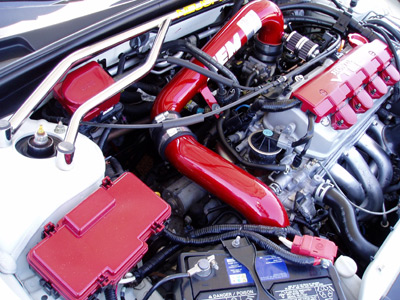

engine bay

lookin really nice, how did u paint it? and a nice addition would be to paint the battery tie down thing

DAMN those are some nice cars! O and BTW your engine bay turned out great! GOOD JOB!

what exactly is "sand-blasting"? i've never see anyone elses valve cover come out so good. i wanna try it..

where i work we ahve a lot of these.http://www.trinco.com/leftframe1.htm. diffrent sizes.. one is so big i can probably do a cars hood. but we dont deal with cars where i work. I work in an aerospace company fixing the hot section of the arplains engine... well anyway i took my parts to work the other night and blasted then on the machine. it strips everything out saving u time compared to sanding and scuffing. i used the 200 grit machine it left it nice and smooth. and its good to do this i did it to my door pannels when i painted my interor and the paint is sticking for its life. i repanted the engine cover after i blasted it and the paint stuck good with no fisheye...after everything dryed up i used my cars touch up paint to do the lettering..u gotta have a steady hand for that.
