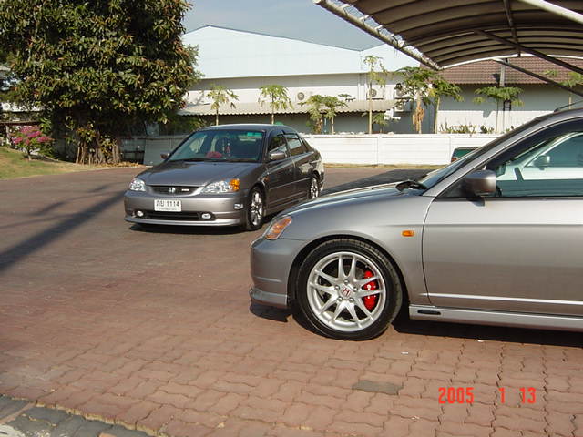

Go amber!
Name:	p obb p chai2.jpg

Originally Posted by Berg_Tomaru
Go amber!
OMG HOTNNESSS!!!! amber is the only way to go IMO, and as for that car, that is sick!!!!! 5 lug ... mmmm
