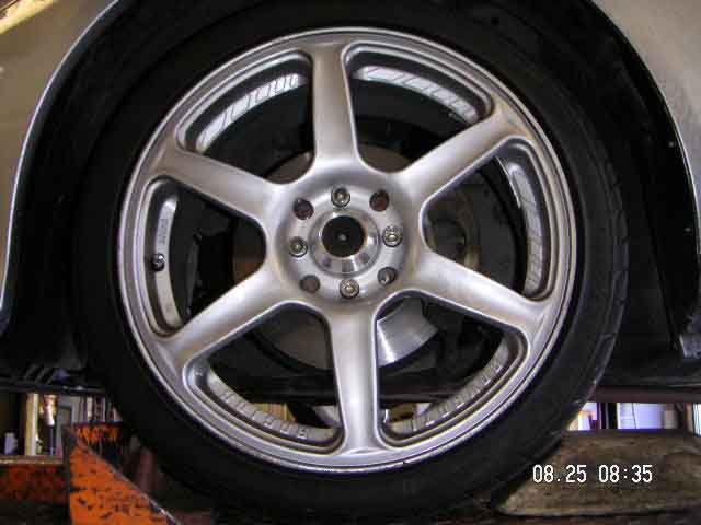

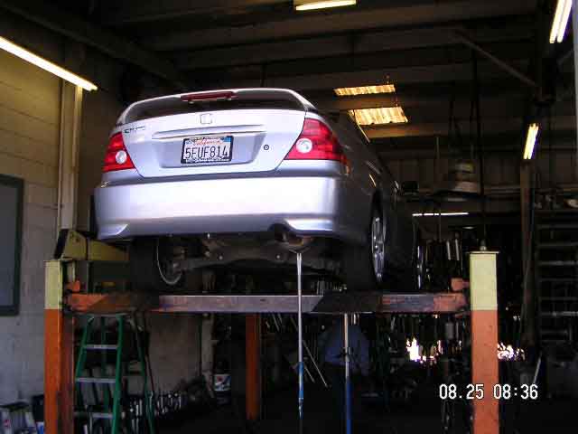

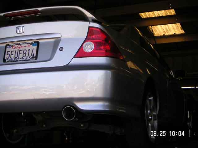

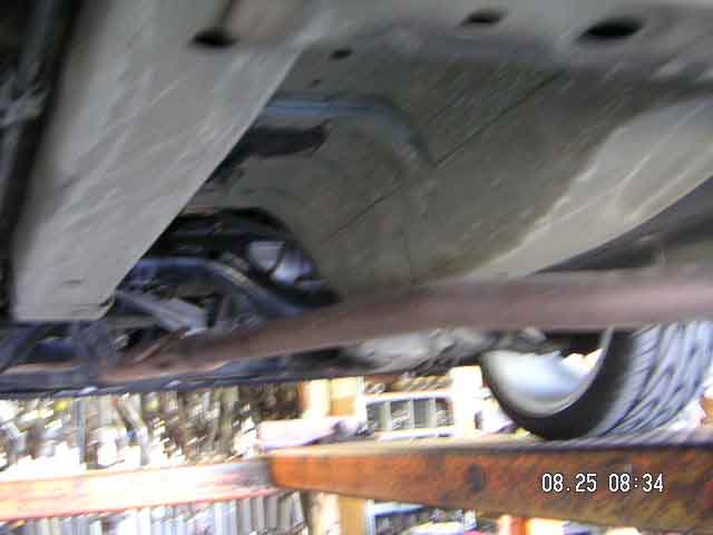

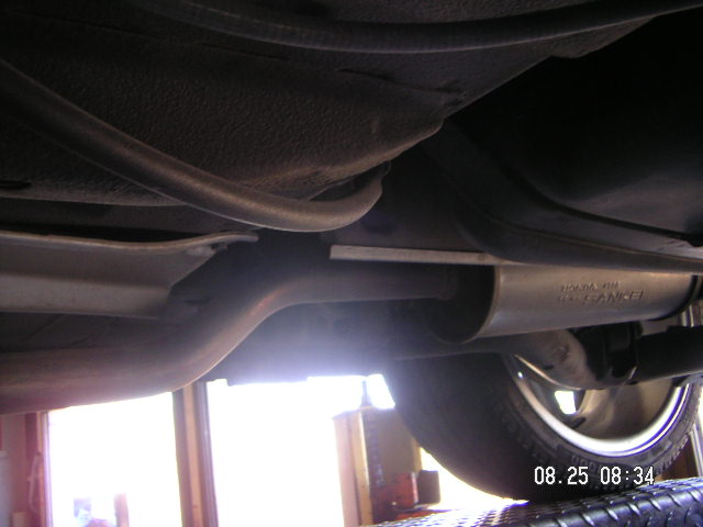

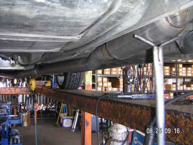

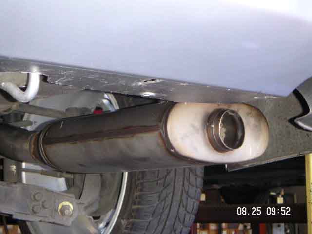

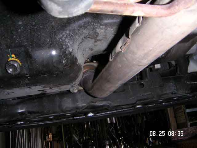

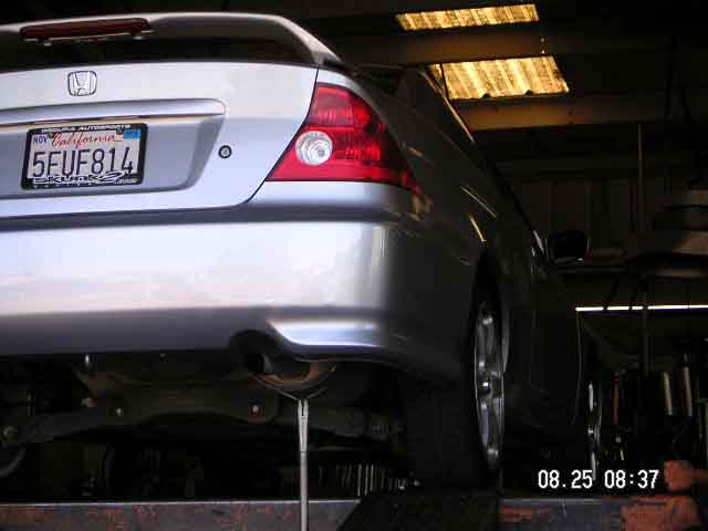

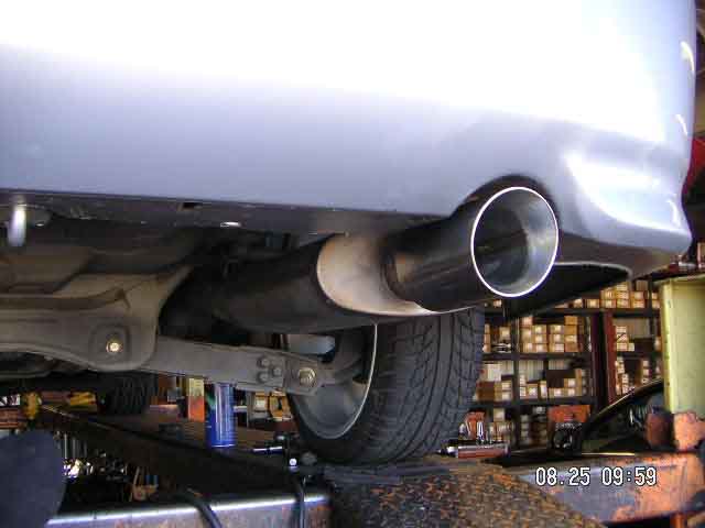

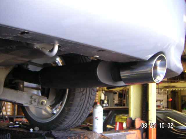

exhaust system and better rims pic
magnaflow custom exhaust system w/resonator 2.5" piping cat back

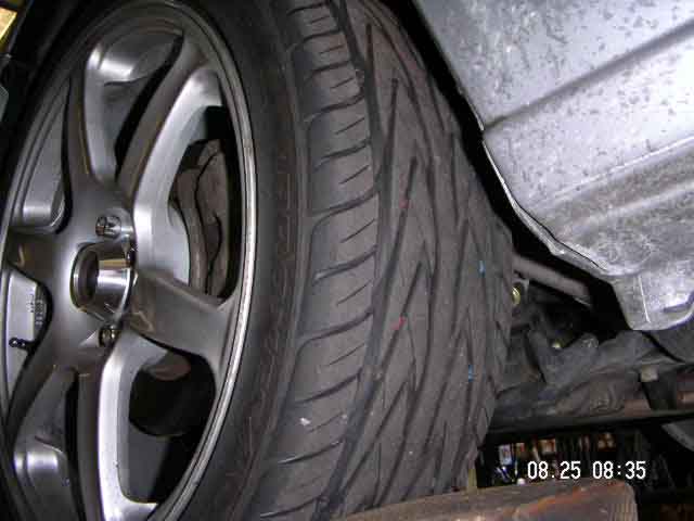

17" Katana Concept 6
fron tires Toyo Proxes 4
rear tires Pirelli P7000
tires are 205/40/17

Just curious, why would you elect to run two different brand tires with different tread designs? Isn't that not recommended?

i had 4 pirrelli's but one had bubble on sidewall so i didnt have 400 to spend on all 4 and the rears were fine anyway...there u go

omfg i love this new exhaust. nice and low tone and not super loud. great for repeling cops

easy i didnt put a new cat, i cut the pipe right after the bracket that holds the cat and exhaust piping, and welded it with a 2.5" piping all the way down to the eshaust tip, its all one piece

yea i understand that but wont that throw a code? what did u do with the o2 sensor u took out?

hmm well i didnt have to do anything, was none on the PIPING, but maybe u reffering to vtec models, cause i got a non vtec. hmm sorry if i could help u out more.
anyways no code needed

if you are talkin about the EX exhaust system, the O2 sensor is right BEFORE the catalytic (spelling??) convertor. and since he got a CAT-BACK, the new piping starts after the cat. get it?

LOL...look at the difference in piping size compared to the stock and the aftermarket!
Which reminds me, I need a mid-pipe
