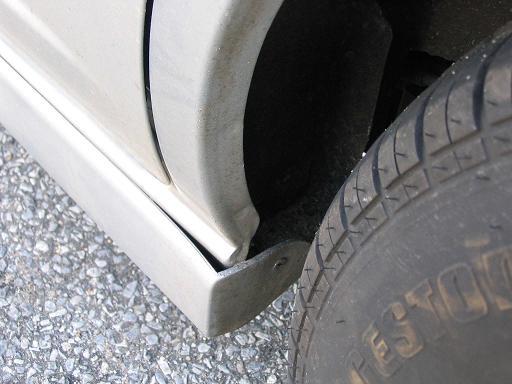

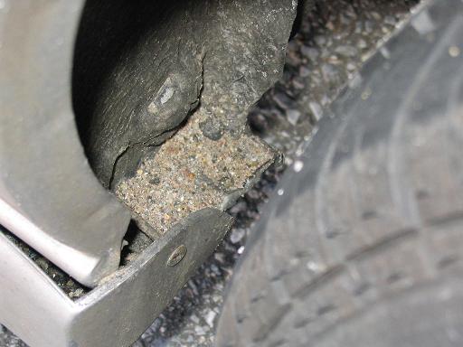

i had the same problem as u dont worry... the door rubbing the sideskirt can be fixed. this is what u do:
***(before u do this make sure that the car is jacked up in the rear because u will need to take the rear wheel off in order to mount the rear part of the skirt. for the front, u need to turn the wheel left and right so that u can maneuver ur hand and screwdriver behind the tire in order to tightly secure the screws in the front wheel well that will be holding up the skirts.)
1. put double sided tape behind the sidekirt on the top edge where it can stick against the body of the car.
2. u mount the skirts front first, have a friend hold the rear side up while u mount the front. before u do anything u peel about 5 inches of the double sided in the front part of the skirt. leave the backing sticking out from the top so that u can pull on it later. align it and mount it.
3. re use the screws thats holding ur splash guards to mount the two arms in the front of the skirt (refer to my memo on the top to make this easier for u). push the skirt in so that the double sided tape will stick. make sure it is aligned! u should have the back piece of the tape sticking out above the skirt.
4. slowly peel about 5 inches more of the backing of the tape and align it and then push it in to stick. keep opening and closing the door to make sure that the part of the skirt that is already stuck on to the car with the tape does not hit the door. if it does, re align it again then stick it on. continue doing this working ur way slowly to the back. remember to keep opening and closing the door after u have stuck the tape on every 5 inches making sure that the door isnt hitting the body. u might have to align and push the part under the door a little lower so that it wont hit. u will run into a little problem once u get towards the back. ill discuss that in step 5.
5. by now ur probably cursing out loud that the back piece doesnt fit, its too short! dont worry... have a friend help u push the rear part in, forcing it to get the skirt as close as possible to the body (it may not be perfect but it will be close enough). while ur friend is holding that in for u, peel the last of backing of the tape and push it in hard so that the rear part of the skirt will stick to the body. dont let ur friend let go of the rear side of the skirt after u have stuck and pushed the rear part in for the tape to stick. tell his azz to hold it for a sec.
6. u will need a power drill, phillips head drill bit, and two 5 inch long self tapping screws to finish mounting the skirts (this is why u need to take the rear wheel off because u need the room for ur arm and the drill to properly align the screw straight into the skirts rear screw hole and into the wheel well). your friend should still be holding the rear part in for u! put the screw in the hole in the rear part of the skirt and tap it into the wheel well. align it properly, so that it is straight, then drill away until the head is about 1cm away from the surface of the side skirt. from there tighten it by hand, so that u dont over tighten and snap the rear part of the skirt, until the head of the screw is securely resting on top of the hole. tadaaaa!!!! ur side skirt is securely fastened.
7. take a break, smoke a cigarette, have a beer, because u will have to repeat these steps all over again to mount the other side. lol
***suggestions:
-remove one rear wheel at a time depending on which side ur doing first.
-(trust me!) becareful not to knock the jack out of the way!!!!
-for u super **** perfectionists out there, if u want the side skirts to fit flush against the body without cutting and re fiberglassing it, i dont suggest u do this but u can take a hammer maybe a mallet and pound the **** out of the rear quarter panel edge that flaps over the bottom part of rear wheel well about half an inch to 1 inch inwards until the skirt goes in and looks flush. (it might be just a little itty bitty tight, but thats the closest ur gonna get to perfect). its kind of like rolling ur fenders in a way but just that bottom part. becareful not to over do it and screw up ur rear quarter panel. REMEMEBER! i do not suggest u do this, but if u have ***** like to roll ur fenders urself, chances are u will be able to do this.
p.s. here are some pics on how it will like, these are from Jayfreazy's car which i hope he doesnt mind me sharing with u guys. after i get my skirts painted back from the body shop maybe ill take DIY pics if theres enough interest.

one more thing if u really want to cut it to fit better, cut it at that line where the edge of the fender and the door meet. ive seen these style of oem skirts before on other cars at the body shop where the side skirts are composed of 2 pieces and the edges of both pieces of the skirt meet at the line where the fender and the door's edges meet.
2 examples of cars that use this style of 2 piece side skirts are:
Lexus IS300 sedan, stock sides (not sure about the wagon)
Ford Focus hatchback, sides (not sure about the sedan or wagon)
another car that has something similar to this is the hachiroku - AE86 Trueno- Toyota Corrola GTS. this car has 3 piece sideskirts. if anyone is familiar with this car u might wanna check that out too. these pertain to the JDM factory sides and i think the J Blood sideskirts as well (not too sure).
i came up with this idea a while back but i was too lazy to try it and on top of that i had no time. so if someone decides to try this, pls. let us know how it turned out and show us how it looks.
