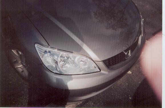

hey guys...
my girl- friend...... (not gf....but a friend only)
bought a 2004 ex coupe...
hehehe...
SO! i shaved all the ex and civic, and "south motors" sh.it off....
and i decided to CLEAR THE HEADLIGHTS!
---> Problem...
the orange inserts don't clear, casue if you take them out, there is a big ugly hole, and you can see straight to the other light...ugly sh.it...
------> so we decided to paint it chrome...
THAT DID NOT WORK..... it turned out silver.... but.... IT STILL LOOKS GOOD BABY!
question.... is this the first 2004 with "cleared/painted (inserts) headlights" on this board????
here are some pics.... enjoy...

Old Mar 2, 2004
keffin's Avatar
Posts: 1,545
From: Miami, Florida, US
Rep Power: 308
again before
Name:	2004 diy 2.jpg
Old Mar 2, 2004
keffin's Avatar
Posts: 1,545
Rep Power: 308
after
Name:	2004 diy 3.jpg
Old Mar 2, 2004
keffin's Avatar
Posts: 1,545
Rep Power: 308
after again
Name:	2004 diy 4.jpg

keffin's Avatar
Posts: 1,545
Rep Power: 308
i have cleared my boys set from his 2000 civic...
we did just that! ---> put "aluminum tape" on them, and it looked sick!
the problem with the 04 is that the refector is not flat like the 99-00 or like the 01-03.... the 2004 reflector has ridges that come out, and go back in... as you can see in picture #1, trust me i tried the foil thing first, but then i was like FU.CK it.... to much work!
so i painted it silver...
FYI! you must paint both sides of the reflector, cause you will still be able to see orange with the light on if you dont.
AND... dont load it with paint.... do a couple of coats of paint...like 1 coat every 10 minutes..... NO CLEAR COAT!!!!!!!!!!
remember to lightly wet sand it before you paint!
IN ALL!!!!!!!!! it was not that difficult.... same process as the 2001-2003...... (except you dont have to take out that little special screw to take the chrome peice out)....the chrome stays.... just part the headlght with the glass/plastic whatever...and go from there
-keffin
