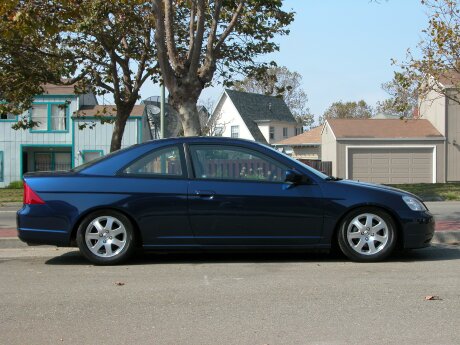

What I consider the perfect drop of a clean ride.
Wallpapers are very possible.

yea man i totally agree..
that truck is very clean and just set at the right height adjustment..
hats off to the owner..
j/k man, looks real nice!
keep it up!!

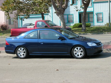

Need to retake this one some time.

what kinda suspension setup?

nice drop man . What kinda springs, how many inches, and are you rollin on stock shocks?

I personally feel the back is just a tad too low. But thats just my opinion. That car is fantastically clean though..shiny shiny. Good job.
gc sleeved coilovers

If the pictures were larger you might change your mind, but unfortunately they are.
The distance from the fender lip to the center hub in inches is:
Rear: 11 1/4
Front: 11 3/4
The rear is a tad low but you really can't tell for a couple of reasons. In the larger pictures, I'm convinced that the front looks lower than the rear but it's REALLY hard to tell because the rear wheel well doesn't arch over the tire like the front. The rear fender lips are are also angled inward towards the well. In most cases you don't see it as it blends in with the rear tire on dark colored cars in some pics. Depending on the angle or light, it can look too high or too low. If I measured the rear from the outer body (before the lip curves in) then the height would probably be considered perfectly even.
In the end, an evened out ride front to back looks best IMO. I can't go any lower in the front though and I don't plan to. This is the ride height I want to keep on 15s w/205-55 tires.

to me, the perfect drop is when the edge of the fenderwell is the same distance all around from the wheel/rim's lip. Although rim tucking looks awesome, I don't like the camber usually associated with it (especially the rear wheels).
That's car looks good though

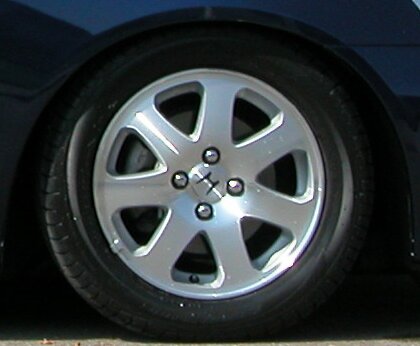

I have a camber kit in the rear and you couldn't stick a baby's finger between the tire/fender lip. It's considerably a lot more positive than it is without a camber kit but if it was any more positive the tires would rub. It is as positive as it can go in the rear but overall it's still negative. I like some negative camber given how I like to drive my car, and it's set perfectly for my needs.
Okay, again... the height is evened out all around. Here are cropped picture of what the wheels look to the fender wells in the second picture.
Rear:

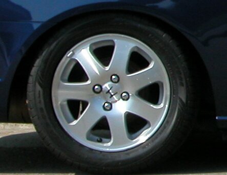

Front.
There is only a 1/2 an inch difference between the front and the rear, and that's something you can't really see given the rear fender lip. Like I said, if the rear fender didn't curve inward like the front, then it would be perfectly even. I did my measurements.
It was actually a lot lower in the rear before, but I just thought I'd lower the front more. (Can't go any lower.) Now it's a lot more even.
Like my sig says... "Even out your ride height."

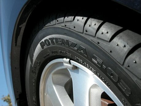

Here's an idea of what my rear camber looks like.
