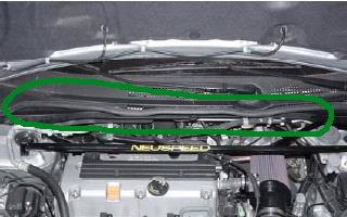

anyone got some pic for neuspeed upper strut bar on 2k2 civic?
today I tried to put it on, but both side strut is not straight up to setting in place, what i means is if I set strut on passenger side first, then driver side must use "force" to align over studs to fit. Its so tight, strut bar is touch back of thing, see pic~
Is this normal for eveyone got neuspeed, my is 2002 LX coupe.

the pic shown is Civic Si, i used that for me to explain my problem.
thanks

yeah that's normal, line up the passenger side and maybe even have someone hold it down while you force the other side into place.... this pre-loads some tension in the bar and helps firm everything up. once you have it all jerked into place, just keep pushing on it until it's flush. then bolt it down and you are good to go!

finally, i installed my strut bar today, and I did jack up the driver side to make it fit.....so tight~
