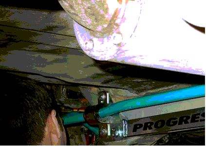

Recently got the "Progress" Sway Bar kit with Tie Bar. This is honestly
the best kit on the market for our cars!
I don't recall the exact numbers but I can tell you that they are bigger and
stronger than the bars on the Intega Type R!
A couple of the local Type R guys have driven my car and are foaming at the
mouth because they can't get this kit for their rides.
Progress only makes this kit for the 2001 + up Civic Coupe, 2002 + Up SiR (Si - US)
and the RSX as they all have the same suspension setup.
The kit includes the front and rear lower bars and the tie bar.
Those who only want a kit for cosmetic or the ever popular "just to have it" should
probably steer clear of this kit as it's not cheap and is VERY Extreme! It's a true
Slolom setup if there ever was one. I had them installed just before I had my Konig's
and summer wheels put back on. Took the car to a wet parking lot and put it through the paces (on winter tires) and the dash didn't dip even a bit despite the severity of the turn I was in! Now that I have the summers on all I can say is "OH MY GOD!"
Needless to say that the B16ers around here are a little pissed because they can't have this kit and are now trying to get custom brackets made so they can run at least the rear bars. It's nice to have the edge over the B16 for once...lol.
One peice of advice; if you get this kit and you already have a custom exaust you may have to make a small modification. The exaust will likely need to be hung higher at the rear (as mine did) since the rear pipe into the muffler will probably touch the bar.
Cheers!

that is the one that will not clear the dc tcs exhuast correct? i am not able to move my exhaust higher either because it is already real close to the bumper. anyway i can lower the exhaust with some longer hanger rubbers, maybe a half inch or so, and squeeze that rear bar in?

I got the exaust custom hung after the bar was installed
and it's fine (DC TCS). At first it was a little noisy but only when the pipe
was cold for some reason, after the car warmed up it all went away. No matter
now, the rehang worked really well.

I have the DC5 rear sway bar, i put it on today, whom i got from Hondawerx, this thing flawking rules. Im very close to the TCS but i am not resting on it, however when i turn hard left i hear a small knocking, not enough howerver to make me get it fixed though. I can notice a huge difference in the suspension with blown shocks. IMO either the Progress bar or the Type R bar is the best way to go. BTW, do you know if you can upgrade your endlinks also to the same size? Cause im sure there is way too much flexing in it.

The rsx rear sway is only 19mm. The progress is 22mm. Looks like u got the ugly light blue one. i think that one is nasty!

blue don't matter, you can hardly see it anyway..the front is charcoal.
