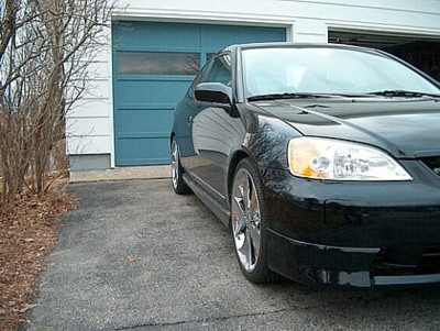

I also have H&R Sport springs with Koni adjustable shocks. I like the ride and it's not too stiff or too soft. I think the drop is a little lower than the 1.3" after it settles, take a look:
