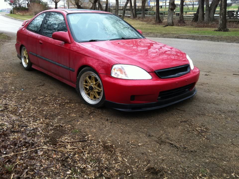

No, Koni Yellows can handle extreme drops. I think you're confusing Koni Yellow with Koni STR, which would blow if you dropped very low.
OBK has been lowered on a modified KY/GC setup for years.

Old Apr 19, 2012
max785's Avatar
Joined: Mar 2011
Posts: 66
max785 is an unknown quantity at this point
Re: Help me to choose the right coilovers
damn ! nice car How much is it for both ?

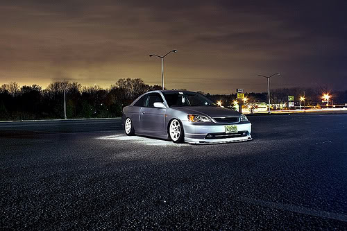

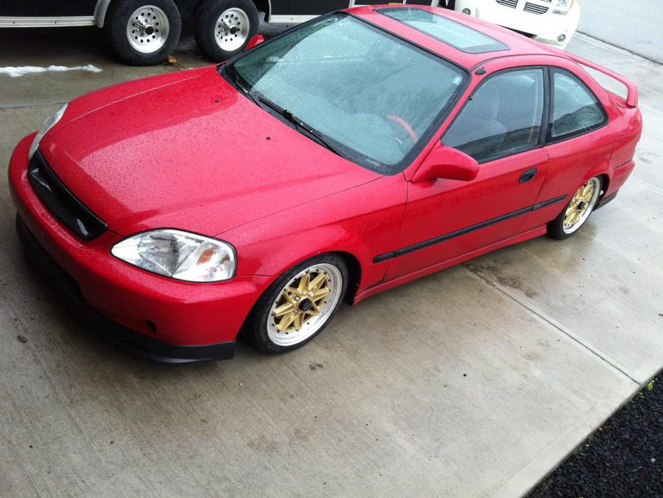

im on skunk2 pro series s v2 they are awesome super stiff and handle amazing!.

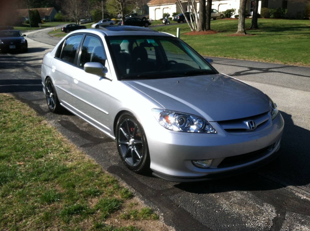

I am ALSO on Skunk2 Pros V2 and they are great. Stiff, not bouncy and easy to adjust. I love them.... They are also decent quality and sturdy. I have seen full coils that look and feel like tin foil the Skunk 2's do not.
