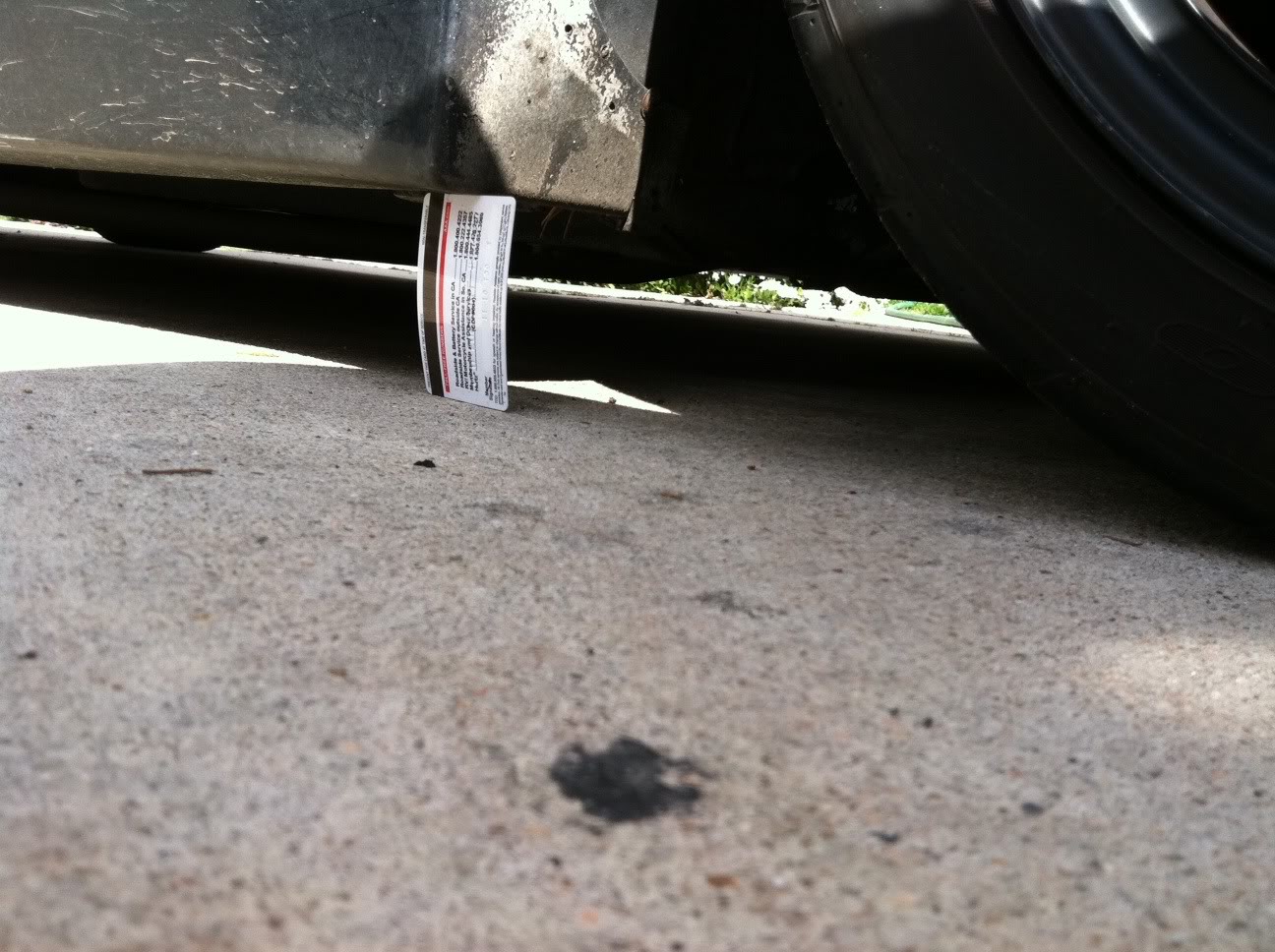

low? what chu kno' bout that!
and this was after i raised it an inch from being tired of scraping everything

^ god dam lol
Still not low enough though
Good thing you took off the mud flaps..
