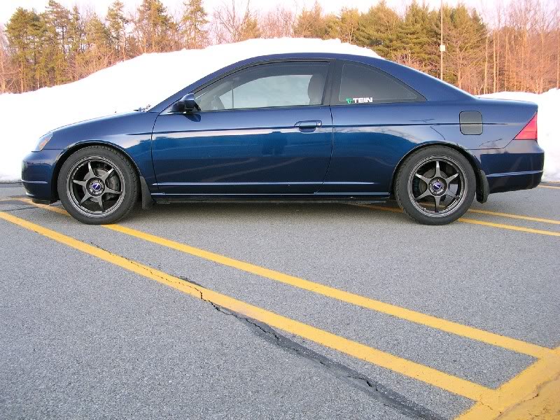

here's what my car looked like with 215/45-17 dropped on s-techs

I think that drop is perfect for me. So you say theres no rubbing what so ever and your on tein s tech? Did your spring settle yet? How long was the s tech installed? Are you on stock shocks or aftermarket?

I don't have that setup anymore. That picture is over 6 years old. They were on stock shocks for a while, then I swapped out the shocks for Tokico blues
