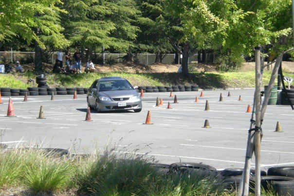

So my cars lowered on ksports, has roll center adjusters and rear 22mm sway. This weekend I went to an autox event, and my car had so much body roll. I am on the stock alignment, is this why I got so much roll? I need help trying to eliminate body roll anyone have suggestions?
Heres a pic of the roll.

that really doesn't look that bad...i'd look into a stiffer spring rate and maybe a bigger sway for the front

try a bigger front sway...look for either the RSX Type-S 23mm or an 01-02 25.4mm Front sway...the civic sway is wayyy cheaper too...I got mine for 30 shipped......also, try to do an autocross alignment....I dont know what the settings would be but I am sure some of the members where would be able to tell you what to set your camber and caster and your toe......

Stiffer springs are a possibility. I'll look into that.
Doesn't a front sway promote understeer?

depends on what your other settings are.. you could always let off the gas a bit to fix that...

shock more stiff, race coil with high spring rate,strut bar neuspeed etc..,sway bar progress technologies 24mm full ajustable ( come with tie-bar ) , X brace 4 points or 6 points, remove isolation, spare tire, light mag (oem= very heavy...SI= 18-19 lbs each ) try all that first!

Ok, Your setting the car up for compitition.... So, One thing you need to learn is to Ignore bodyroll as it is a Very poor indication on how well or how poorly a car is handling. The second is to absolutly, Positivly DO NOT INCREASE THE STRENGTH OF YOUR FRONT ANTI-ROLL BAR. that is unless you want more understeer and the amazing ability to put less power down coming out of turns.
What should you be paying attention to????
1. How is the car handling? Too much understeeer? Does it feel like your hitting the front bump stops? If you are running in to understeer, where in the turn is it happening?
2. Watch your tires for roll over, how much? What PSI are you running and whats your alignment look like.
BTW, Chassis braces do precisely squat when it comes to chassis roll.

Just some shots of my car in compitition running substantually softer springs then you and a 15.9mm front anti-rollbar for compairision.

Thanks Zzyzx for confirming that increasing the front sway only increases understeer.
The car never hits the bumpstops, never understeers, and handles pretty damn good. I'm running the falken azenis rt-615s at 34psi all around. With the ITR rear 22mm sway the car feels pretty neutral. If anything it helps the car rotate a lot better.
One of the problems I had at that autox was that it felt like the tires were not gripping. I dunno if it is because I didn't get a chance to warm them up...etc, but the whole time I had this eerie feeling the car was kinda slidy.
What kinda alignment do you recommend?

For compitition on this car... At least -2.5 Deg camber on the nose. a comprimise for street + comp would be between -1.5 and -2.5.
34 psi with the stock alignment seems low, Have you chalked your tires to see how much roll over your getting? Back when I was running the RT-215's on a stock aligment I had to run around 45-48 on the nose to keep the tires from rolling on to their sidewalls too much. Once I got a more compeditive alignment on it (-2.5) I was albe to drop the front PSI to around 35-38 depending on the track. The rears pretty much stayed in the 30-32 range. For more rotation you could try increasing the rear psi above that.
as far as the tires feeling slipery... were you being smooth entering and exiting the turns or were you being jerky with the controls?
What Region are you running with in SOcal?

Yeah the car looks fine in those turns. More negitive camber & more seat time!
