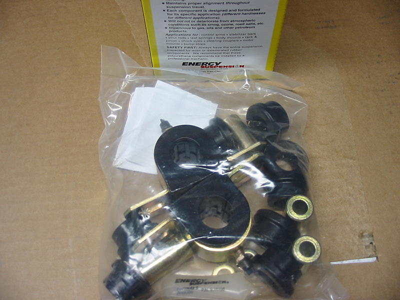

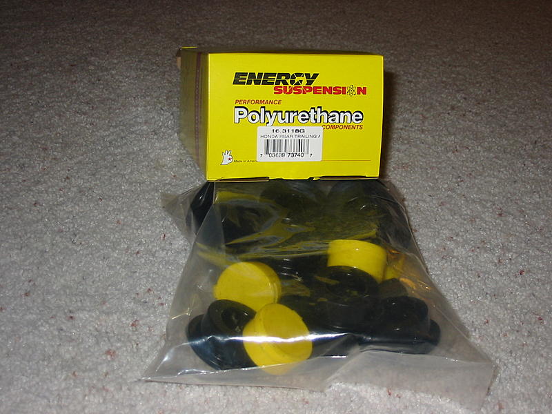

Energy Suspension Rear 22mm Sway Bar Poly Bushing
Energy Suspension Front Control Arm Poly Bushings
Energy Suspension Rear Contrl Arm Poly Bushings

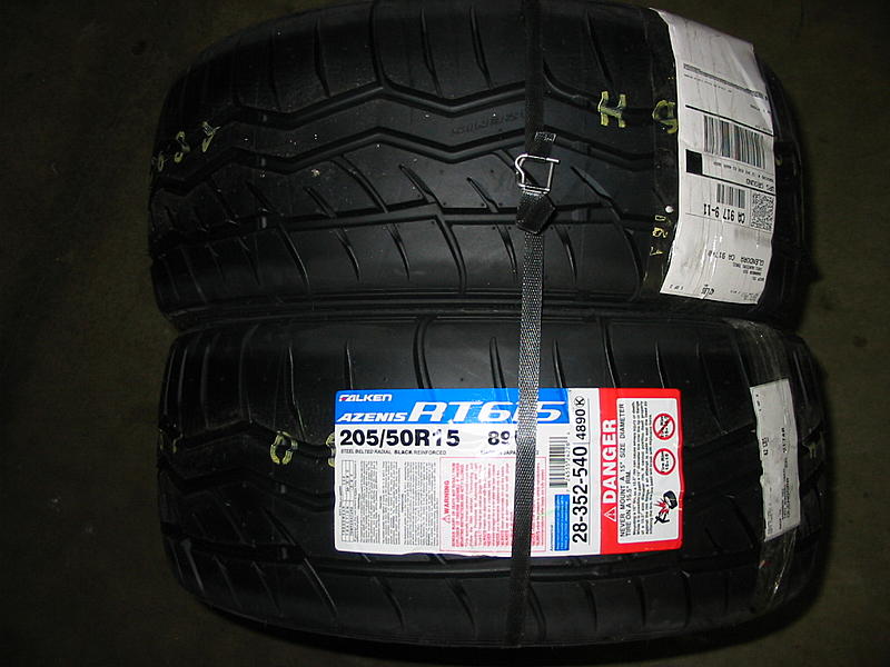

A Set of Falken Azenis RT-615

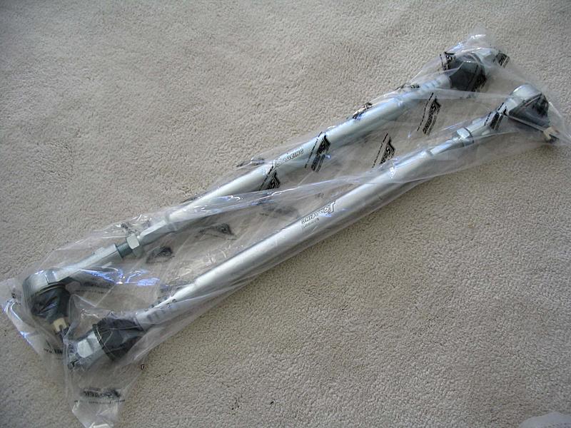

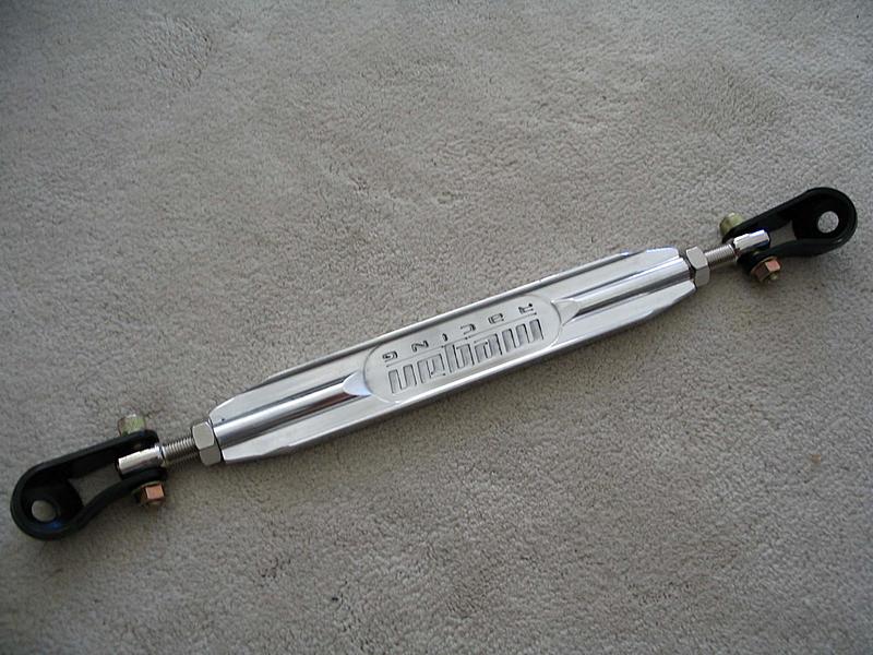

Megan Tie Bar
J's Racing SPL Tie Rods

The ones I have are made to fit a DC5, so I have to still modify the coilovers so the tie rods fit. But I was told the EP3 version of these tie rods are a direct fit. I just needed these rods quick and the companies around here only stock DC5. For EP3 tie rods expect to wait 4 - 6 weeks on special order.

i don't know much about them so whats the deal with those tie rods? are they thicker/stronger? more adjustable?
This is from the AJ-Racing.com,
"For the suspension setup for EP3 and the DC5 has been changed from double wishbone to McPherson strut so when the car is extremely lowered the front steering rods will become too short for toe adjustment.As a result, there will be insufficient adjustment to get the proper toe setting. With the J's Racing SPL steering rods, it allows sufficient adjustment and steering control is also remarkabily improved."
I think they worded that wrong or something because I think when you lower a car your rods become to long. So these ones are shorter and will let you get the proper toe. Someone correct me if I'm wrong here on this one.

The energy suspension bushing for the front and rear control arms might not go in. A very reputable shop that does alignment and corner balancing has told me several of their racing customers have tried it and not like the results. I'm not sure if I should put these in or not, I might just hold onto them for awhile.

What size are those tires and for the energy suspension bushing i have the front ant the rear on mine and i love them night a day difference i could not see how you would you not like the results of the bushings.

Goodtimes - The tire size is 205/50/15 w reinforced sizewalls.

Thanks man, I appreciate the love. As for the tie rods, I have the DC5 ones, I couldn't get a hold of the EP3 ones.
Does anyone have any suggestions for making the DC5 tie rods fit? Several ppl tell me you can make them fit and they will work, but no one has told me how.

J's Racing Tie Rod went into today, the install went smoothly. They bolt up just fine, but I haven't gotten to look at the work in detail yet.
The drive home was fine, there a lot more steering feel. I cannot comment on the performance, didn't get any alignment. Soon...on the 21st...
