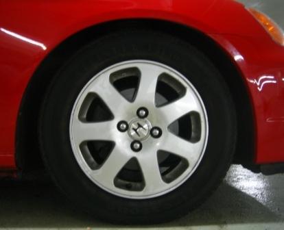

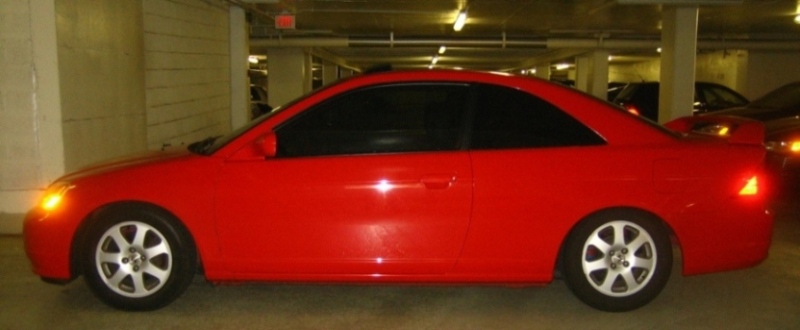

Does this Neuspeed Sport drop look normal?
so i dropped my 01 this past weekend on neuspeed sports with tokico blues and spc camber kit. immediately after i took my civy off the jack stands, the fronts looked fine but the rears looked higher than the stock. i threw my tools in the trunk and took it for a very slow, short test drive around the block. after that, the fronts looked the same, but the rears dropped super low. the tires are in the wheel well. i'd be happy if that's what was supposed to happen, but they're way lower than 1.5" and this is only after maybe 30min of settle time.
has anyone experienced this or have any idea what might've happened?
also, whenever i went over bumps, the fronts sounded kind of clunky like something was loose. i haven't driven the car after that.

Normal
the clunking is normal, the reason is your sport springs are shorter then stock and there more coiled. So whenever u go over a bump or dip your springs hit against each other. Just get some coil wrap. I have that same sound to

The back looks way too low to me. How much stuff do you have in your trunk?
Clunky front: Did you wrap the bottom of the spring coils? (the OEM springs have a wrap glued onto the bottom).

yea the back seems too low, i have like a 1 1/2 finger gap all around with 18" rims

i guess i'll have to get a coil wrap for my fronts for the clunking. is there a kind that i can use that doesn't entail taking everything out again?
i don't have a system in my trunk. the only things i have back there are the equipment i used to lower: 4 jackstands, hydraulic floor jack, torque wrench, creeper, small ratchet set, and the jumper cables i always keep back there.
would those things make it drop that much?

well, i just got back home and took all the junk out of my trunk. i forgot that i also threw my stock shocks and springs in there too, but civy didn't come up much. i still have no finger gap in the back. my fronts have settled to a one-finger gap. looks nice, but it still worries me that it's twice as low as the specs give.

i think it seems kinda normal with neuspeeds. i have the exact same set up and the same deal happened to me. i got rid of the firestones and put 205/50/15 falkens on and let me tell you, it made a hell of a difference. for one, its a smoother ride and secondly, a cleaner look. for some reason, on an even surface, my car seemed even all around, some times the driver side would look lower but i think all hondas are like that.

Hey, that's how neuspeeds sports are.
My car looks the same. The back didn't settle till afterwards, just like on your car. I've had mine on since February.
Here's a pic of my ride. It sorta looks funny with back with less gap than the front, but I really don't mind it that much.

interesting. yeah, that's pretty much how mine looks, but i'd say i have a negative 1 finger gap in the rears now that it's settled after a week.

i still have my stock tires and also have the spc camber kit installed

It doesn't look like it's sagging. Is it rubbing? It looks good to me.

nope, no rubbing. actually, the ride is pretty great. i'd say better than stock, and i even had two 150+ lbs guys and a 100lb girl in the car while going over some pretty bad bumps.
