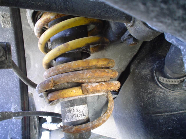

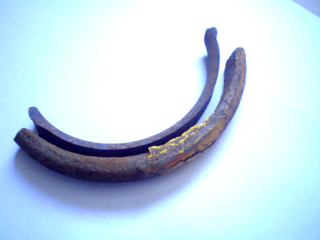

Here are my rear coils after 2 years. Springs don't look well.
I like the drop and look but one coil got broken. I've bought my coils from tornactive.com and still have recipt ..
I'll try to call and get them replaced under warranty.
Any sugestions.... welcome.

[B]I did call the GoldLine, and they'll replace my springs with the new set of 4. Set is on the way to me. WOW. I'll send them my old broken set .. tho (later on) for metal testing or something. I am OK with that. No problem. Now I have something to do over the comeing weekend. :-)

look at the amount of rust on those. I wouldnt blame goldline 100%, looks to me like salt ate away the metal. Im sure these werent designed for winter use.

wow those look totallly ****ed up for being only 2 years old...atleast they are replacing it...

I am able to drive this car with broken spring .. it's about 0,5" lower then other side.. no rubbing or dragging .. but You can tell that left side hang lower....
YES .. springs are rusty .. it may be Illinois winter problem .. lots of salt on roads... looks bad.
