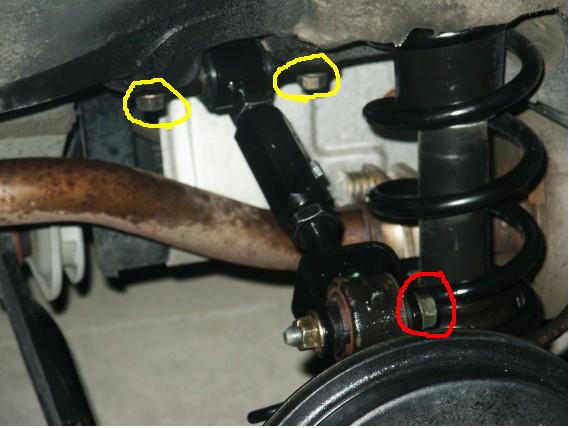

The yellow circles are the ones i got off succesfully. the one circled in red is the one that wouldnt budge..... the nut to the left of the red circle i held in place while trying to turn the red circle.
is the red circle the welded one???????
iwas wrong on the stock arm the left nut is welded.....that bolt comes out....damm...lemme think.

Originally Posted by Mr.Modify
did you put a wrench on the left one and pushed towards the car .....and put a wrench on the other one and pull away?
the one circled in red is the only one i tried to turn and after it didnt budge i gave up without trying the other side. you say that one of them is welded...... lets say if i got the one of the left out, the the bolt it welded then how would i get the arm out?

wait wait wait ......okay on the stock arm.....i think the left one is the welded one.....so your right....you were doing it correctly!! the right one is suppose to turn and come out...

obviously the one in the pic isnt welded since its not the stock kit but yeah the nut is welded, the bolt isnt... are you turning it the wrong way? i know i've done it a couple times before. your pulling it from the top, down right... dude i wish i could go over there and show you how a real man does it j/p..

well, i got the rear camber arms in today. you guys were right, the nut is welded and the bolt comes out pretty easy. i shouldnt of been so quick and given up yesterday after i tried unscrewing the welded bolt haha.
anyway, this install was so easy. 3 bolts in and out, couldnt get simpler. i adjusted the camber the best i could but now my tires are hitting the fender. on monday i'm gonna have to cut more of that inner lip off. before the camber kit my wheels tucked under the fender really well cuz the wheels were like / \
