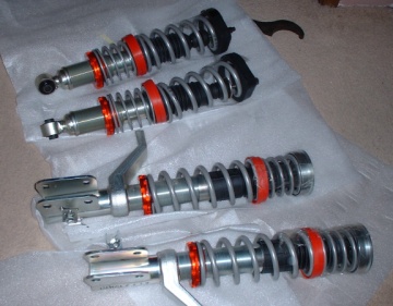

So after countless broken promises, estimated time arrivals, and such for the hayames...i finally decided to cancel my order and upgrade to B&G...Thanks to Eddie (aka TrueHonda) for the great price and awesome customer service...
Now I was wondering if people could give me some helpful tips and warnings on installing them...
Should I install them or just go to a shop and fork out 100 bucks to free me of the hassle??

just install them yourself
it takes like 45 mins max
and make sure you put the bearing rings in or else it will
clank when turning the wheel

also, when first installed...is it recommended not to slam it first, but rather let it settle at a higher height, then slam it to my liking?

just slam it all the way....that's how my car is....
no problems at all...

Those are my pix. You don't need the grease. The clanking sound I had was because I forgot the upper strut bearing as Vinh posted.
For the ultimate B&G thread. Check here: Huge B&G Thread
Also: Upper Strut Bearing Discussion

After reading the huge B+G thread...Do the bearings have to come from a certain year...say 01 civic?? ( It does say 2002+ on that pic )
or do all years apply...

^^Okay so, its better to have the 01 upper mounts?? cuz the B+G was designed according the 2001 model...
Do 02+ bearings break or tear because of this?

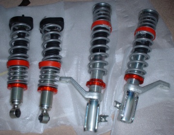

wtf...also check out my pics on the very first post...
It looks like the helper springs on the front assembly is on top....shouldn't it be on the bottom????

use the grease. It conditions the bearings, keeps the noise away, and makes it easier to install.
