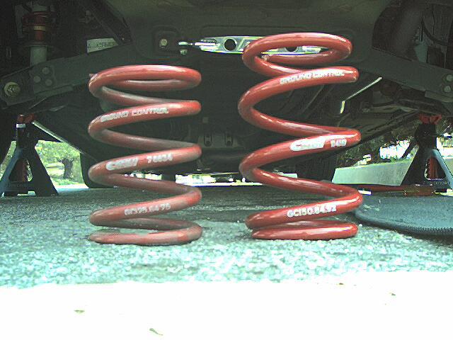

the left one is 5 inch 425 lb (the crap that comes with the 7thgencivic GC kit)... the right one is 6 inch 525 lb (comes with RSX GC's)

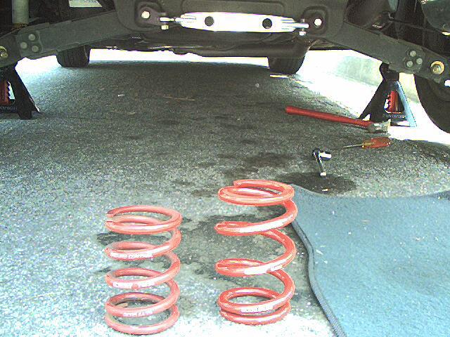

another..

just finished installing them... i love the stiffness, i had to soften my koni yellows a bit though because it was a bit TOO stiff (they were adjusted all the way firm)... so i did 1/2 a turn back from full dampening...
i don't have to worry about having passengers back there because i doubt i will bottom out with the extra inch of spring travel... and the extra 100lb in spring rate should compensate for when i decide to get a sub for my system...
overall, i give the RSX GC springs an A+
