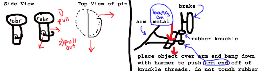

The three bolts require a 19 mm socket wrench (I think)
The two bolts at the endlinks require a 14 mm deep socket.
The cotter pin has a long end and a short end It looks like |,
Pull the short end out of the hole with a pair of pliers... Then when the pin looks more like a V shape instead of a |, shape, pull out the pin at that corner of the pin where it starts to go into the bolt.
You might need to use your OEM floor jack to keep your brake held up high to ease assembling and disassembling the a-arm.

To pull the knuckle out of the bolt, do NOT touch the rubber because if that breaks you are screwed. What I did was I put a hard piece of metal on the arm connected to the nut, and I banged on that metal with a hammer so that it would push the arm (nut included) down. Without touching the rubber.

Yea I forgot the bolt sizes but I do know that the endlink bolts are 14mm.
What I did was I supported the brake with light pressure from the OEM floor jack. Then I used the 17mm sockets to take off the two HUGE bolts from the huge parts of the control arm (closer to the engine). You will probably need a socket wrench extender (I did).
Once those are loose, taking off the part under the rubber knuckle is easier. But not that easy. Be sure your car is stable before you do anything because you don't want it to fall on your head. You'll be needing a LOT of umph to undo those bolts and well.. What I did was I put wood blocks on top of those tire ramps and rested my whole side of my car on that (that 2x4 looking metal bar running down the side of the car).

Yea the block of wood is good enough. But since you'll be throwing the whole arm away anyway, it doesn't really matter how hard you bang/damage it right?
But I guess the wood will get rid of the ear-clanging noise. You can also put a regular wrench bigger than the threads of the screw.... on top of the bolt underneath the knuckle and bang on that wrench. Either way works.
About the horizontal bolt.... it's only threaded about 1/3 the way up the screw. The rest of the distance from the threads to the head of the screw is blank space. So the only thing that's keeping the bolt in the hole is pressure/friction. You probably already unthreaded the screw from the threads in the hole. Find like a screwdriver or something and put it beneath the screw head.... across the length of the screw at a 90 degree angle. Then pull it towards the screw head to help push it out. ----\-[] Like that.
You might also try banging the screw from the other end with a hammer and some sort of metal object. I think I tried method one and it worked best.
