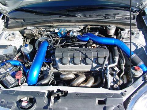

Ok. If you have visited the forced induction forums within the past 6 months, you probably know my car. If not, here is the jiist of it...
2002 lx Turbo
~275-300 whp.
Before my motor work i ran a 13.6 @ 102 mph @ 3000 ft. on stock suspension and 15" Azenis
Now DHracing has helped me out quite a bit with my motor.
Anyway, to get back to my question. I build turbo systems. I am not a suspension genious. I would like to have some of your opinions on what all you people think i should use. I am fully sponsored by several companies, so cost is not too terribly much of an issue.
When i race, i run on 15" GSR rims and falken 205/60 azenis. I have serious traction issues. I cannot hook up unti i hit 4th gear. I have to run my low boost setting until 3rd gear, then i turn it up. on my low boost (7 psi) i can pull off 2.0 60/ft times. I would like to cut this time down by .2 sec AND launch on at least 10 psi. I am trying to run mid 12's on a radial, and the stock suspension is just not cooperating. Which brands/models should i look into?
Any help is greatly appreciated. I am looking into springs instead of coilovers.
