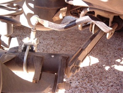

Which parts are you referring to? The mounting point for the endlinks on the arm? If so, thats what the progress kit replaces, along with the endlink itself. Check out this pic showing the removal of the stock bar. That part on the bottom where the endlink mounts to the arm is not there. Plus it's welded on, so you can't get it from the dealer.

Here's a pic of my RSX bar attached to the Progress kit on the driver side, just to give you an idea of how it works. I rotated the tires the other day and got a good pic of it.
