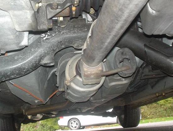

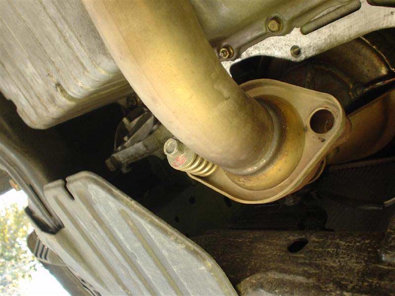

As I found out today, the 2003 HX has no factory front sway bar, but it does have the mounting holes, the only problem is that there's the pesky catalytic converter so you're going to have to take it off temproarly to put it in, I took some real quick pictures of what the 03 hx's underside looks like. I still think it will work, but if you want a front sway bar for an 03 or 04 hx you're going to have to get a set of endlinks, I'm personally going to go with Greys endlinks. I'll hopefully be ordering me a set of those in about a week.
Here's a shot of the catalytic converter, is this what it looks like for those of you with an EX?

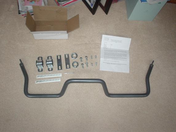

Here's everything that came with my kit, LOOK GREY... GREASE....
I also got the 61.1006 which is the one ment for the EX. I hope it works, but I need end links dammit...

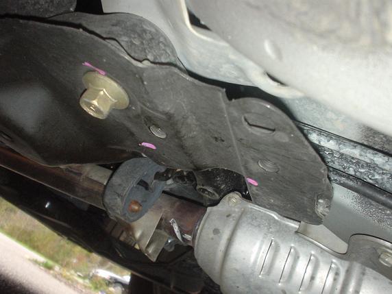

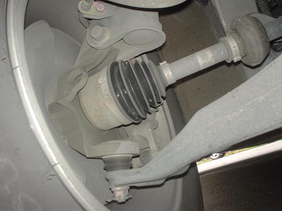

What about your lower control arms? Do they have mounting points for the endlinks?

I think the control arms have the mounting points for the endlinks, I'll figure out tomorrow, and take some more pictures of it, since right now it's too dark out. Also, does anyone have a set of stock front endlinks they'd be willing to send me... cause... It'd be nice to make sure this will work before I spend more money on something I might not be able to use. I'd have no problem paying for shipping, and I'd return them to you one I get a set of my own....

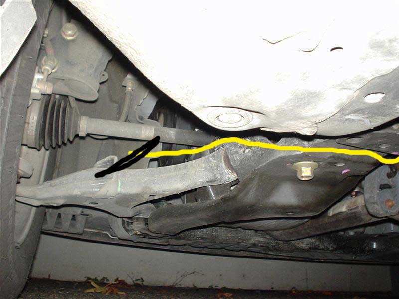

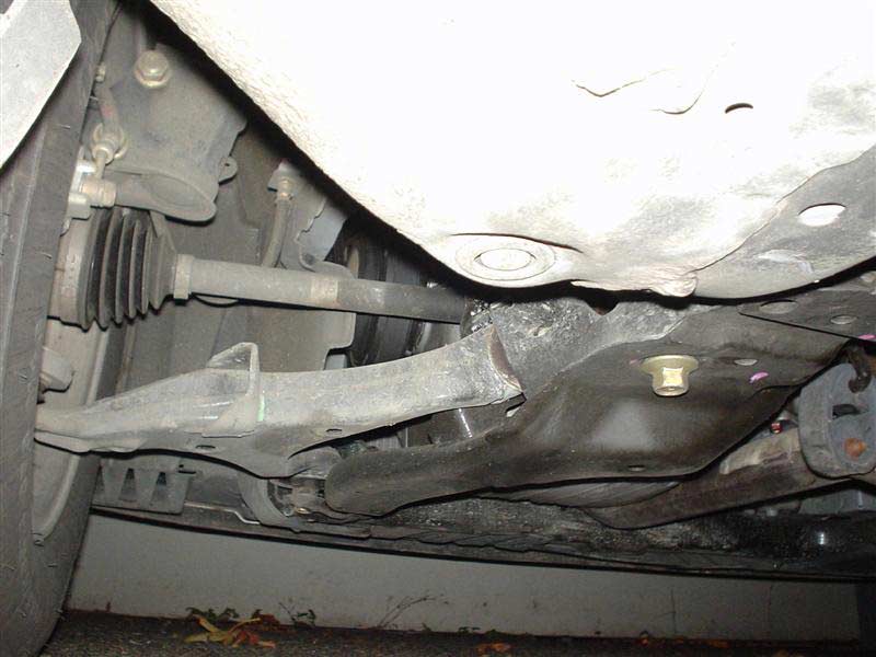

Here's the endlink mounting point... right?
Old Nov 12, 2003
Renamazazo's Avatar
Posts: 1,668
From: Redmond, Washington, US
Renamazazo is an unknown quantity at this point
Here's the front control arm again...
If I'm correct The black line should be the endlink, and the yellow should be roughly where the swaybar is
Old Nov 13, 2003

Yep. Exactly. Looks like you can mount a front sway bar without any problems then.

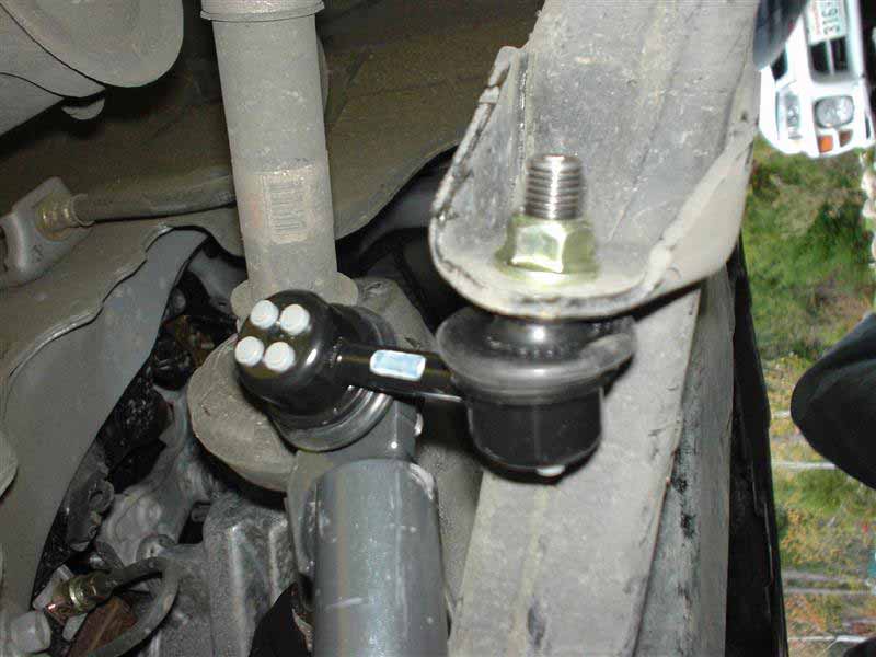

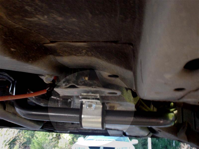

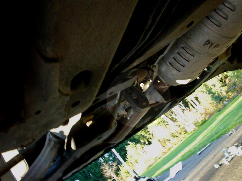

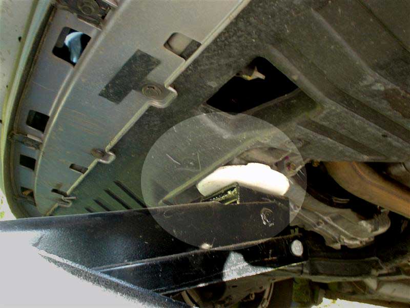

Okay Renamazazo, here's the pics I promised. I needed to rotate the tires anyway, so I shot some pics while I was at it. Hopefully they'll help when you start installing that front bar.
I'll be including them when I format the DIY Front Sway Bar pdf that Grey wrote. I may do that tonight..stay tuned!
Click here for the DX-R site.
First pic is the driver's side endlink.
#2 is the driver's side underside, showing where it mounts to the frame.
#3 is a closeup of #2
#4 is the passenger side frame point, shot from the driver side.
#5 is the passenger side endlink.
#6 is the pass. side frame point, shot from the pass. side

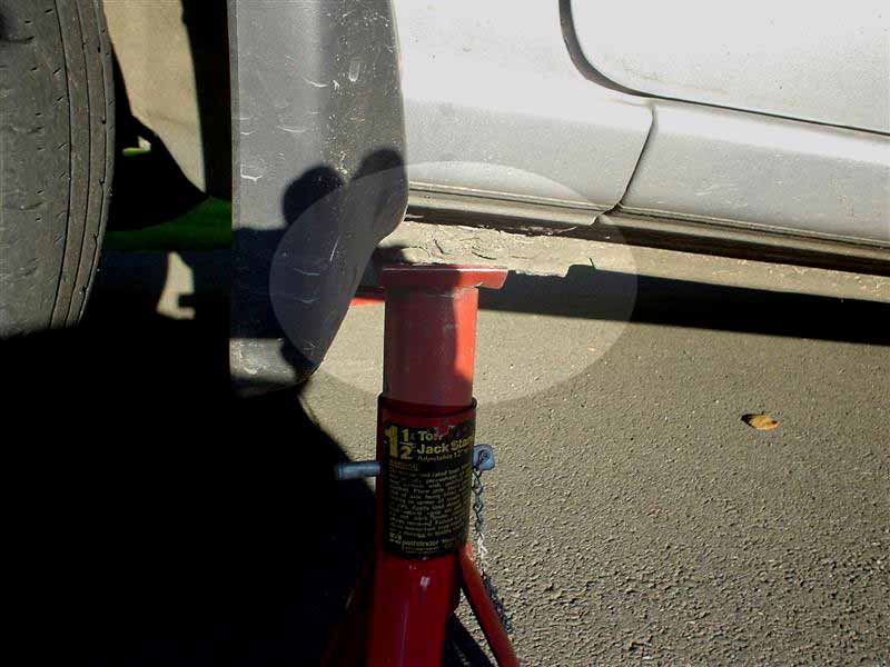

Step 2
Place jack stands, underneath the re-enforced jack stand locations right behind the front wheels.

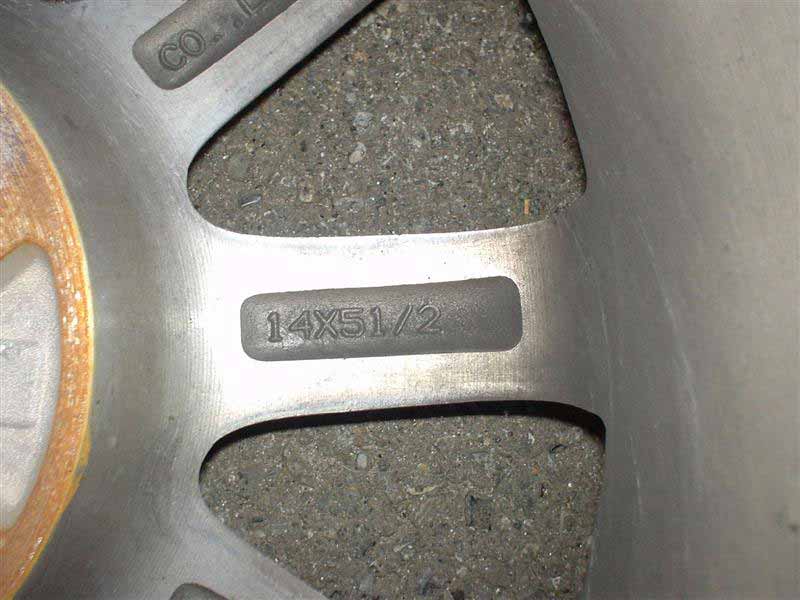

Next, tighten everything down that isn't tight, then double check it, Re attach the exaust to the header. Put your wheels back on, or in my case I just rotated them cause they were bald as hell... In the process, I noticed that my wheels are 14x5, 1/2 which is something I've been trying to find out. Put the jack underneath the same point, jack it up, remove the jack stands, put the wheels back on, only tighten the lug nuts as much as you can by hand, while the car is still in the air. Then let the car down. Tighted the lugnuts to 85 FT/LBS using the correct patter. Then carefully drive around and test out your new swaybar.
I noticed an Immediate difference in how my car behaived, gone are the days of the super leaning civic HX. If you have any questions on this DIY, PM me, or IM me at renamazazo or just leave a response here.

dude, you seriously need new tires...

yeah... they're getting down to the wire... gonna wait till next paycheck or so... then get me some new ones...

HOLY ****!!!!!! 03 hx has the catalyst converter in the downpipe? wow thats cool
damn lx has in the header...hate that ****....im gonna have to upgrade it to the ex exhaust system and xtend the 2nd o2 sensor wire
