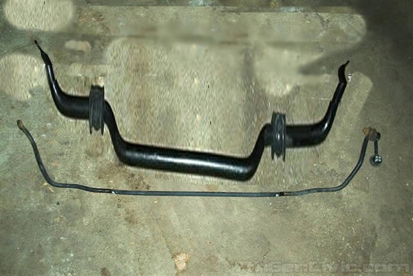

rsx sway bar vs stock ex sway bar....
those of you that dont think theres a difference...
i got news for u...

Sweet. I was wondering how much different it was. . good picture.

Oh yeah...thats what I'm screamin'
and if you have a dx/hx or '01 lx...it matters even more!
I've got it...HIGHLY recommend it. Best mod for the money!

Better proof... put one end on the ground and lean on the other... figure out that the stock one is like a rubber band, and the other one barely twitches.

I calculated it out once, the RSX 19mm bar Vs my EX's old 15mm bar.....
the 19mm bar is 257% stronger......

actually i think its 12mm

I have a 2001, I'm pretty sure it came with a 15mm rear bar.

01 02 has 12mm rear sway bar.
lx didnt have rear sway bar on 01
my si has 15mm rear sway bar.
and new si(2004) come with 17mn sway bar .

Okay, I did a little research on hondautomotiveparts.com and here are the results:
Civics: (all DX and '01 LX have no rear bar)
2001-12mm
2002-13mm
2003-12mm
2004-12mm
Si
2002-15mm
2003-15mm
2000-13mm (for comparison)
RSX Base and Type-S
2003-19mm
And a few others, just to fry your brain:
CRV-18mm
Element-21mm
Pilot-20mm
Prelude-23mm
S2000-27mm
Del Sol vtec-15mm
Accord Coupe 2004-13mm (wtf?)
Accord Sedan 2004 dx/lx 4 cyl-14mm
Accord Sedan 2004 lx/ex 6 cyl-13mm (wtf?)
The most interesting is the Accord bars. Doesn't make much sense to me. And before you try to refute my numbers, my sources were hondaautomotiveparts.com (for civics) and honda.com itself for the 2003/2004 models.

if thats right then the 19mm bar is actually 628% stronger......
