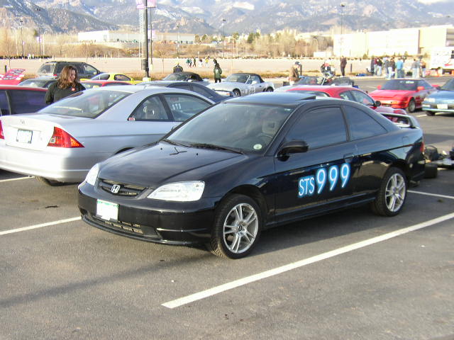

STS ... but I don't care about changing classes if need be. I just want to run the fastest times, and for my first time being in the middle of the pack, hanging with some of the modded cars out there...I think stiffness will help A LOT!!! So thanks for the info!
