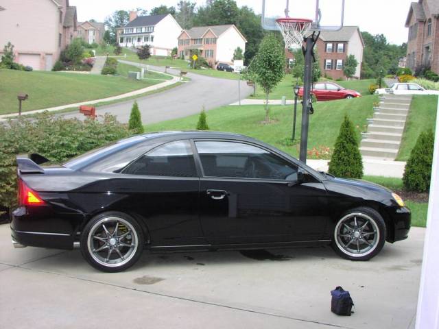

ya i got goldlines and they are finally settled all the way and i like the ride and the drop is perfect for the roads in my area. here is a pic with 17s, it sits a little lower with my 16s and 15s on.
