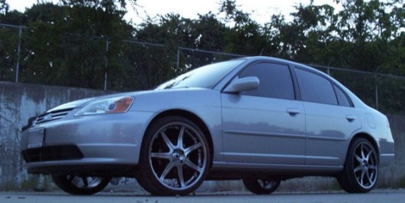

my girlfriends ride on my 19's... stock suspension
