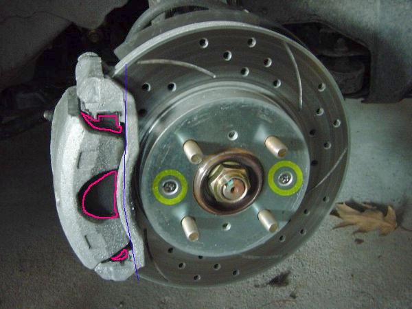

6.put a little strip of paper between brake pad and disc (important, no paint should go betweeen pad and disc)
7.cover the whole brake disc
8.see pic for detail which need to be covered. Area circled in red shall be covered, the blue line represents the little stip of paper which sahll cover the area BETWEEN caliper and disk
