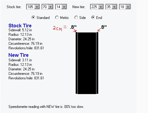

If you look at the tire calculator, going from your stock 185/70-14's on an LX to 225/35-18's, the new tires would be EXACTLY the size. The radius, diameter, circumference, and revolutions/mile. So, if you just replaced your stock 14's with the new 18's and got 225/35-18's and didn't get the car dropped it would be exactly the same height as stock. So, if they're the same exact size as the stock tires, then they shouldn't rub... Unless the stock wheels/tires on an LX rub when you lower it? lol

Originally posted by VNlilMAN
you have to remember the width... its 225 and not 185...
say you have what a 255-40-15 sure it'd be the same size as stock diameter wise but width wise, it just wouldnt fit.
it is true that the 225/35/18 would be wider than the 185/70/14 but the difference is only 4cm which is 1.6 inches. with the same offset as stock, you would move outward .8in and inward .8in.
when i turn my steering wheel all the way either left or right.... i can observe that there is ample space for wider tires. the only way i can see rubbing is if the offset is too far inward or the drop is too low and the top of the tire rubs the fender. or you hit a bump too hard thus causing the tire to hit the fender.
255 would just be silly. thats a ten inch wide tire... something a muscle car should be wearing on the back tires stock.
ive gathered all this information through observation and calculation so if im wrong... be gentle :-p
