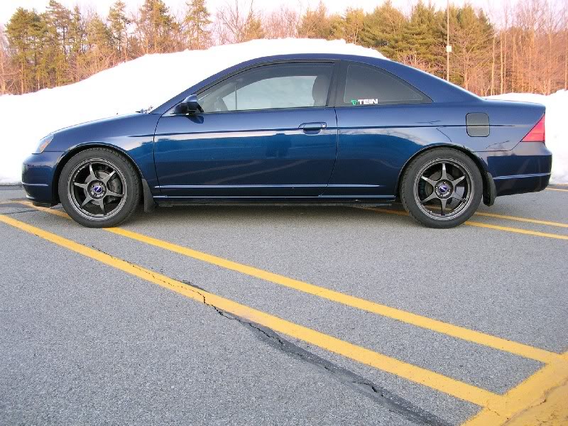

If you want a reference for what an EM2 looks like dropped on tein s-techs, here's what my car looked like when I ran that setup
I also upgraded to tokico blues (amazing struts, btw) and I have an SPC rear camber kit installed. Nice, happy little drop, comfy ride, camber within factory specs. I probably would have kept that setup forever if I didn't come across the deal on the coilovers I now have.
Rim/tire setup is 17" buddy club p1 racing SF's with a +42 offset, wrapped in 215/45-17. Never had any abnormal tire wear or rubbing issues.

Correct your rear will go negative when you drop the car. 1.5 inches is not a whole lot so it won't go extremely negative. The exact number I am not sure but it will bump you you out of the OEM spec minimum which is -1.5 degrees. This is not necessarily a bad thing. When you increase your negative camber you increase your cornering grip (which is fun). So it will wear the tires a little bit more being out of factory spec but you will gain cornering ability. Now the rear end is extra grippy in te back around corners but the front is not because the camber won't change much in the front when the car is lowered. When you go around a corner the car will have better grip in the rear then in the front so it will cause the car to understeer more. This is safer but does not allow you to corner as fast. A camber kit will allow you to make your rear camber more positive which will decrease tire wear and decrease cornering ability for the rear of the car (causing it oversteer more). The same principle can be applied to the front of the car also but when it is lowered the camber is not changed as dramatically as it is in the rear. Also camber effects the toe in the front. I wanted my front camber set to -1.5 but in order to keep it within OEM toe specs the closest he could get it was like -1.3.
So do you NEED a rear camber kit, technically no.
Will it allow for proper suspension tuning and tire wear, yes. If you don't want to stay within OEM specs then that's ok.
The choice is really up to you and what you want to get out it. A car at stock height with stock tires would benefit from a camber kit because it can control how the car handles a turn.

You don't need rear camber kit, but it is recommended.
I don't use them.
I run Tein S Techs on my stock struts, I love the ride comfort of them.
