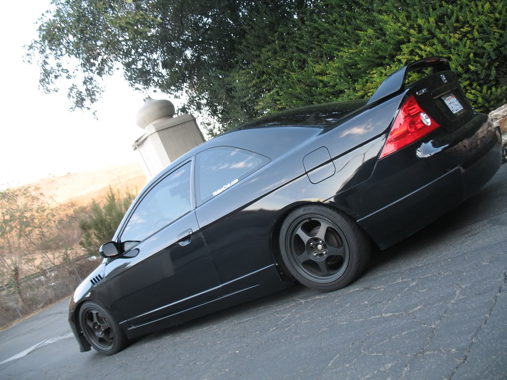

if u were worried with ride quality u would have gone with 16" but each to his own.
im riding on koni yellows + eibach ground controls. 4" lower than stock height (measured next to my friend's 03)
these are on 205/45/17 tho.

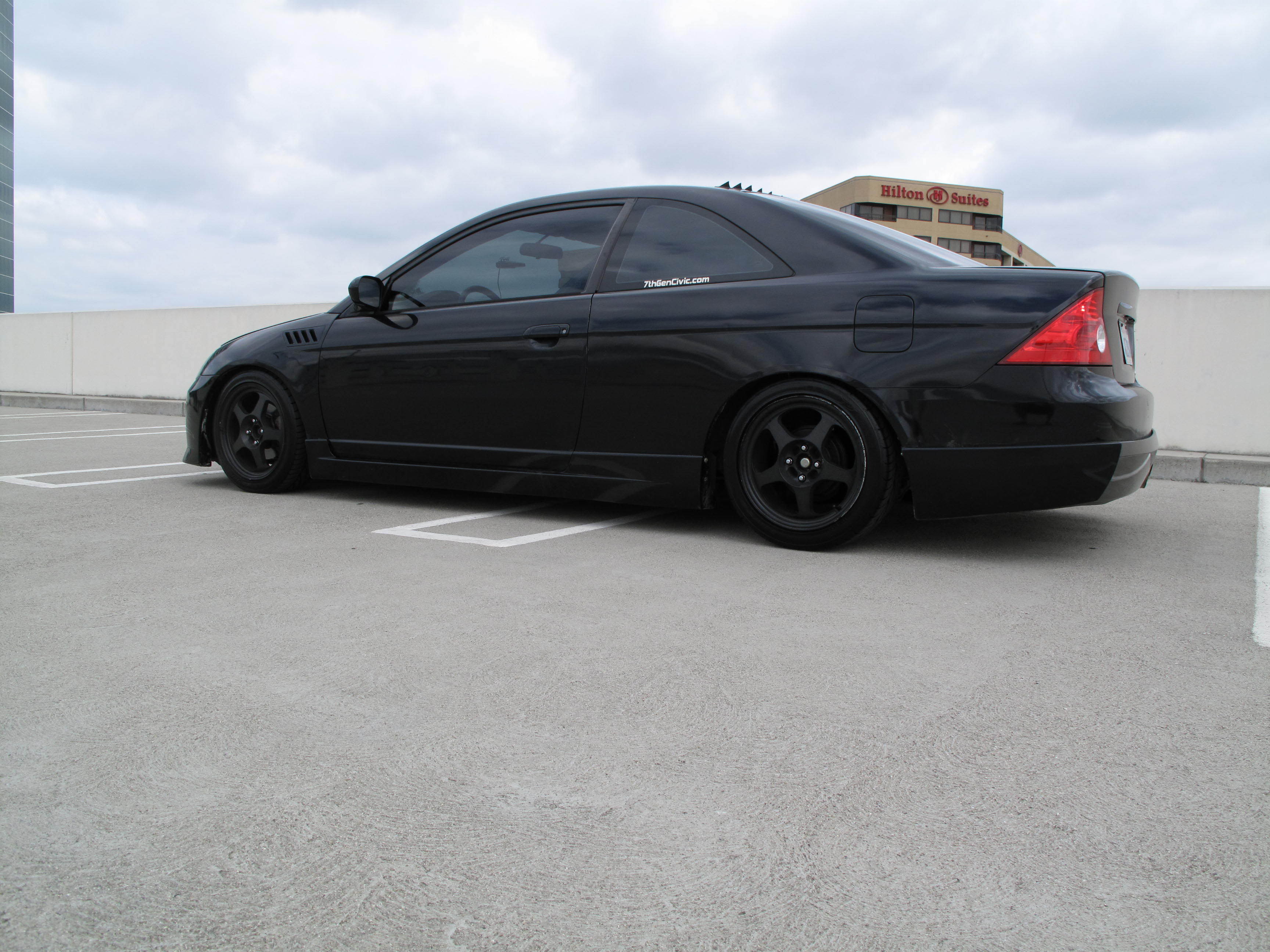

my ride now:
replaced that silly spoiler with a CF trunk
