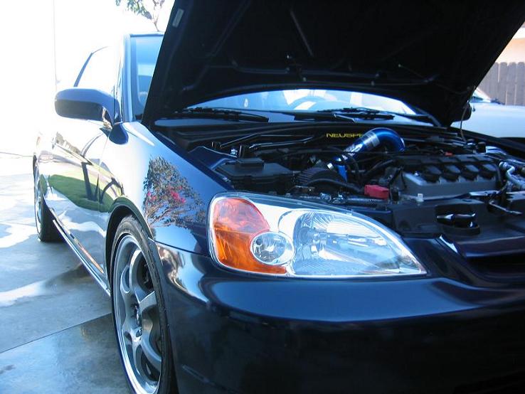

I run 215/40/17 tires and have my car pretty low with no rubbing issues. You will get more traction with the wider tire but lower gas meilage. If the tires are going to rub or not mainly depends on the offset of the wheels.

That does look good but I think for now I will stick with 205 since I drive a lot and don't wanna sacrifice mileage to much. Also you have 215/40 and around here with a 40 series Im just asking for trouble with the road conditions I drive on daily. It seems that 215 is the max for a 17x7 wheel so I would rather be in the safe zone and a lot of people seem to like the 205 plus it saves me $20 on the wheel package I am getting! I cant wait to get pics up mid september!!!
