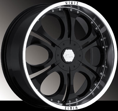

Just found out that the wheels i really wanted are 26lbs. I guess I go back to the drawing board. That choice was made on looks alone.

ouch! 26 lbs will definately hurt!

Finding that out really hurt. I knew they would be heavy but 26lbs never crossed my mind. And they don't make a smaller size
